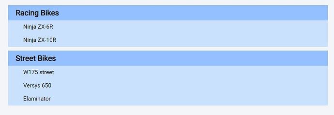

I’m sorry if I’ve been vague. Its half way there though.
Basically, replacing
<h2>
with
<button onclick="bubble_fn_add_headers({output1: 'Header 1', output2: 'Child 1 of Header 1\nChild 2 of Header 1\nChild 3 of Header 1'});">Add</button>
<h2>
Does the job half way.
The main problem I’m facing here is that I have to put each H2 subheader within the output1’s value and a list of H3 subheaders within the output2’s value.
All of these subheaders are user-generated. Suppose the user added 6 sections, that would mean 6 sets of H2 subheaders followed by its H3 subheaders list. In that case, there have to be six button replacements with functions containing their unique subheader texts.
The main goal here is to get those functions their respective subheader texts by any means.
