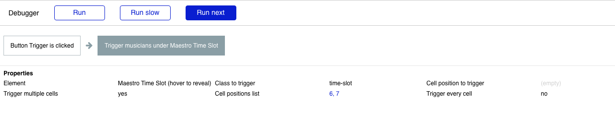

Hi Vini
I am having an issue with the plugin using the cells position list…it seems no matter which cell numbers I push into the dynamic expression, it only every triggers for the cells index based on the number of items in the list.
For example, if I put the dynamic expression for cells position to contain the cell numbers 5,6 which has only two numbers in the list, the trigger will fire for index cells 1 and 2, not 5 and 6.
To show what is happening I’ve taken some screen shots of the setup and some videos to show the debugger in step by step mode.

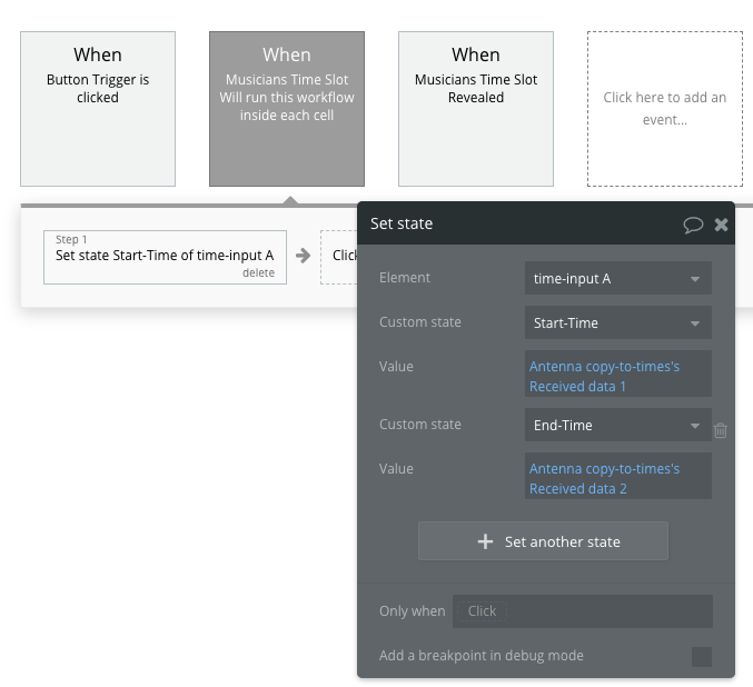

BTW, I am using this plugin in conjunction with the Orchestra plugin as I am triggering events from reusable elements inside of a repeating group on a page…Most everything is working fine, except this issue of the cells position list.
Here is a text element set to display the values coming into the plugin
Screen Shot 2020-11-25 at 2.44.23 PM
Here is the setup for the trigger event to use the Received list of data 4

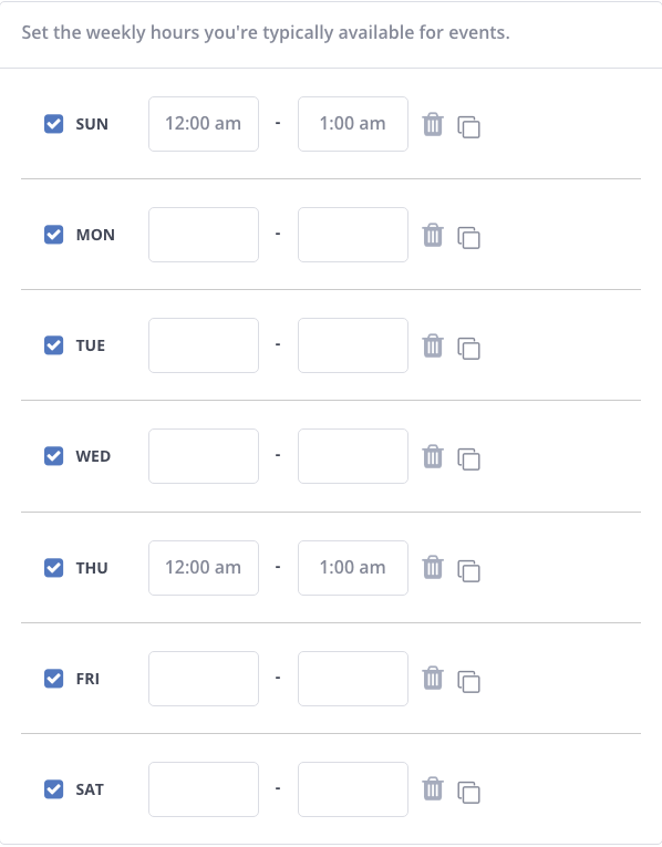

On my page after I run the events this is what I see, which demonstrates the data list values are correct as I have selected those cells
Screen Shot 2020-11-25 at 2.47.36 PM

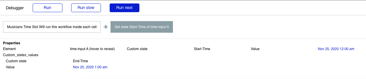

However, when I run the trigger event this is what I see in the debugger step by step…it is not setting the correct list of cell positions…it seems to not take the cell position to apply the values to and instead just uses the list of numbers count or something.
This is what I see in the debugger for the trigger
So in the first screen shot of the workflow event, the Cell positions list is correct, but subsequent screen shots show the values being set, but the result is that only cells 1 and 2 are set, not 6 and 7…my goal in this example was to have Friday and Saturday set, not Sunday and Monday
Is there a step that I am missing to ensure that the values are attributed to the cells whose index number are the same as those in the cells position list?
BTW, when I trigger the event to only trigger in a single cell position, it works as expected.
So, seems like it just has to do with the list
