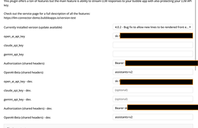

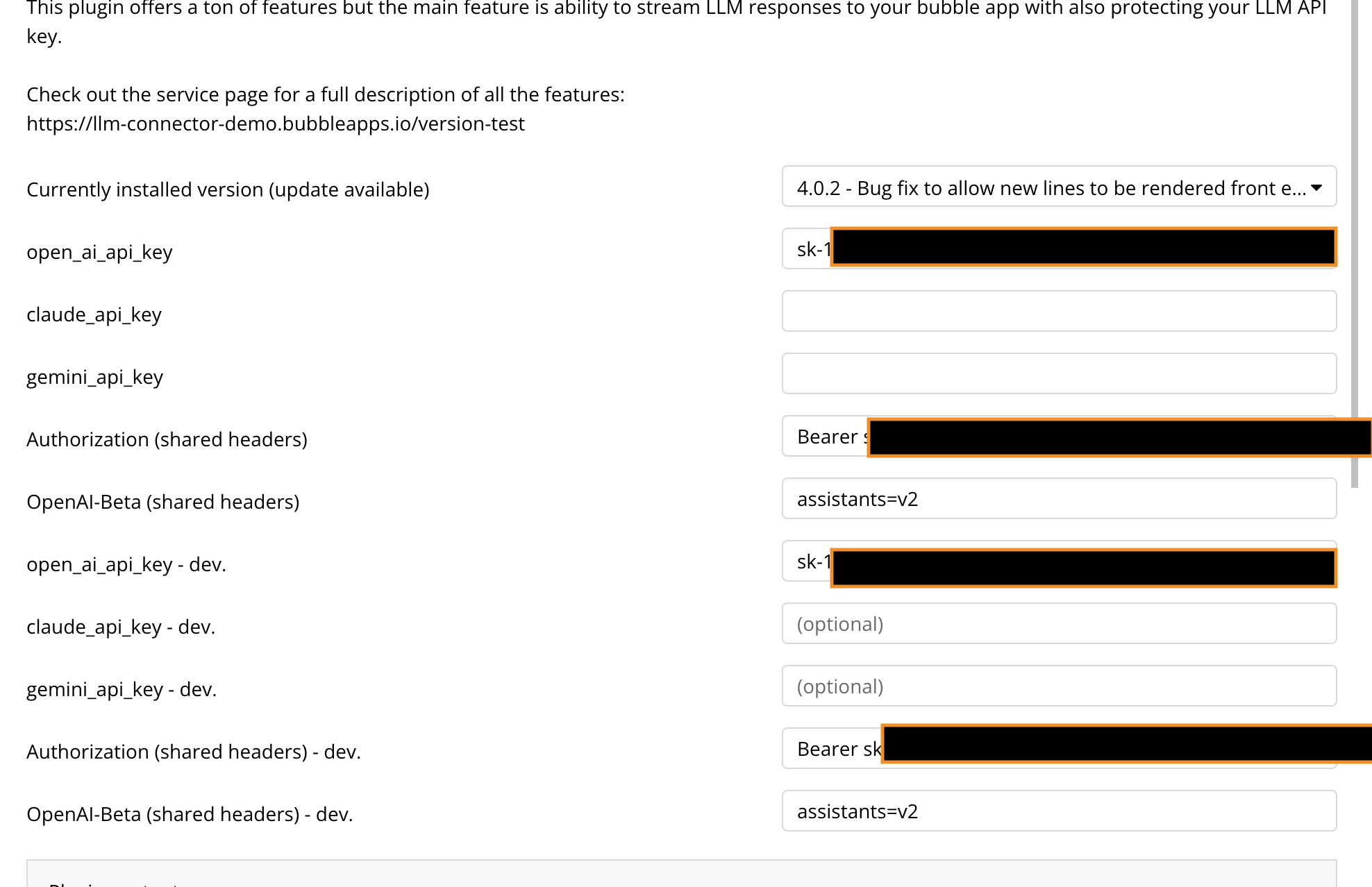

Hi @paul29 ,
I selected GPT-4o in the Assistant and “Generate Tokens” but the Streamed response is empty.
When I change “Generate Tokens” to GPT-4-1106-preview and keep Assistant with GPT-4o, it works fine.
I’ll look into this in a bit
I just looked into this and gpt-4o requires an upgrade to v2:
Migrating from v1 to v2 - OpenAI API
This will take a couple of days to update. Will be done by the end of the weekend. I will respond back as soon as it’s complete.
This is specific to assitants only. Regular streaming or server side calls will work with gpt-4o
I have pushed a fix. You do not need to update the plugin. This is a backend fix. gpt-4o now works with assistants. @ruimluis7

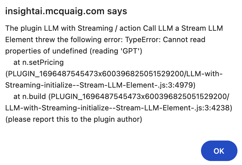

Hi Paul. Thank you for this great plugin. I am facing a strange error, only with gemini-pro. All the other LLMs are working well. I have no error message to provide you apart form the message below:
Thank you for the detailed reply Paul … I sent you a dm
HI @adrien.charles75 glad you like it.
Are you able to send me a screenshot of your action settings? If you’re doing a streaming call, I will need to see the generate tokens action and the Stream action
