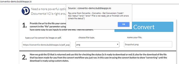

the demo seems to fail with any url I’ve tried
Ive fixed it for pdf, just give png a miss for now until i have some time to finish that too…
Ok thanks!
I’ve just seen it’s ok now.
but I’m still waiting on png case while trying on my own to make it works
its the exact same flow, just swap the application/pdf for image/png as the mime type in the data url.

the demo is not working. After i click on the icon of the converted pdf it is opening a new tab which is blank. I tried the png format and nothing is showing up in the image area

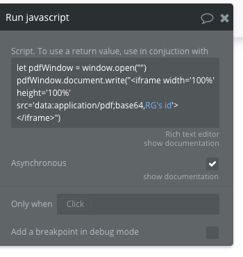

Ok solved it
Use toolbox plugin and run this code
var pdfResult = data_.data.info.result.result;
let pdfWindow = window.open("")
pdfWindow.document.write("<iframe width='100%' height='100%' src='data:application/pdf;base64, " + encodeURI(pdfResult) + "'></iframe>")
Not the cleanest solution but it works

I tried this but did not work.
