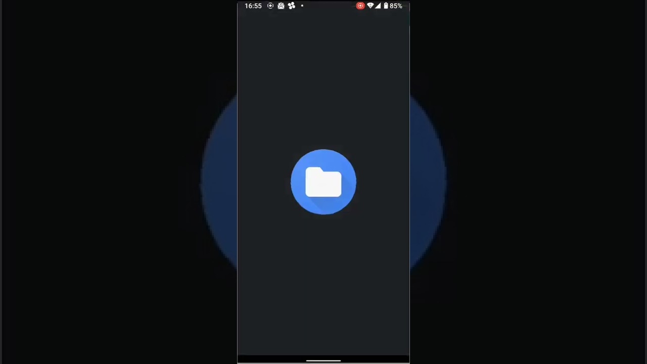

This plugin is working properly on IOS.
However, there is an error on Android.
It works correctly when i first upload the image.
When I try to upload the image a second time, the image is not compressed.
Can you please fix this error?
Please see the attached video
■Workflow Instructions
Select multiple Compressor
“Compressor multiple selected”
→"Compress multiple Compressor"
“Compressor Done multiple compression”
→"Upload multiple images Compressor"
Hi, thanks for the feedback.
According to your video, you are testing with 1 image, so you are selecting the same image for the second time, this is why it doesn’t work. This is a browser feature as it “sees” that this particular image was already selected once during this session, and it doesn’t make sense to select and compress the same image twice.
Please try to test it with different images.
Thank you
