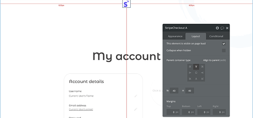

Stripe Checkout Element is on page
Have you placed the stripe element on the page? Ensure it’s in the most top middle.

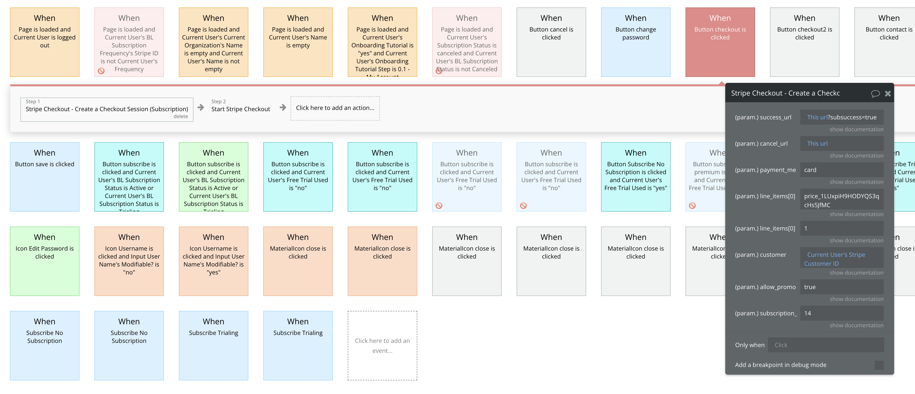

Unfortunately I’m getting the same error. I’ve read the previous posts, and I don’t think I’m making any mistakes. I’ve run the debugger too, and no Session ID is available for the second step of the workflow.
I’m trying to get users to sign up to a subscription, so I don’t think ivanckw’s tip applies (I’m not entering a value/price during the workflow, if I’m not mistaken).
What is happening here?
Can you send me a PM with editor access so I can test?
I think you’re using the customer ID in the workflow from the demo. You’ll need your own here.
Thanks, I’ll send you editor access! Yes, at first I tried it with the Stripe Customer ID that app users had already created through a previous Stripe purchase, but that also didn’t work.
But I was already wondering: if a user hasn’t bought anything through Stripe yet, what do you use as customer ID? Is it a generic Bubble field or something? My previous implementation of Stripe through the general plugin has made it a bit unclear what the default situation is.
Ah, I see. I don’t use the Bubble plugin, but I recall users have reported issues with retrieving the customer id from that and trying to use it here. What I do is store the customer id in a text field on the user, and then use that. I typically use the api to create a customer, but if you’re not familiar there are plugins out there such as my Stripe Customer Portal plugin has an action to create a customer and use it to attach to a user using the Step 1’s customer id.
As a test, try the method of storing the customer id in a text field and running it through the plugin workflow. Ensure privacy rules allow it as well.
