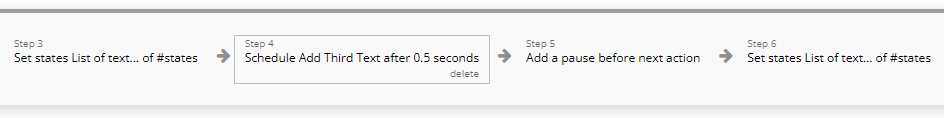

Setting States and Custom Events are client-side actions and will always run in sequence. So do Pauses. Which makes the below work as intended.
Schedule Custom Event actions also follow this sequence. See this example:
So the above sets a state then schedules the Custom Action to run after .5 seconds then the pause starts and ends then sets a state.
2 things to learn from this is:
  1. A client-side action does wait for the previous action to execute. Eg. Step 4 only triggers after Step 3 completes updating its state
  2. The Custom Action runs .5 seconds from the point it was triggered in the sequence so it’s actions can run simultaneously. Yes, Bubble does allow parallel workflows.

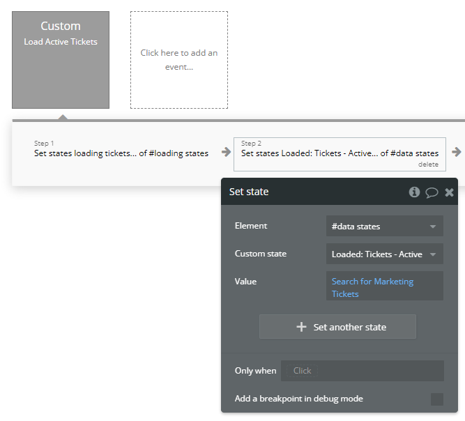

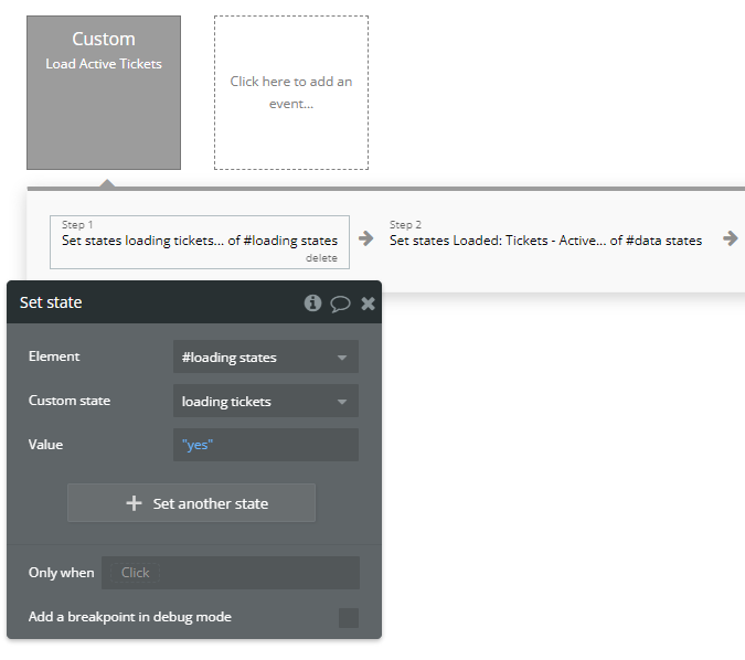

Here’s a simple method.
In my custom event, I start by setting the load state to yes. This shows my loading element.
Then I load the Data into my data state.
Now to there are 2 ways to update the loading state:
I can change the loading state immediately after (or after a pause action) I load the Data into my data state since it is supposed to run only after the data state is filled

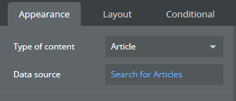

The :count Operator
This costs way less WU than

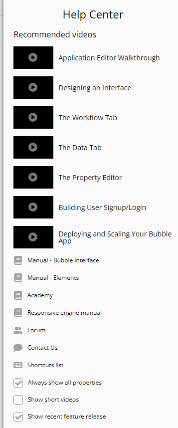

Last But Not Least: RTFM
Click on that Question Mark icon to open the Help Center
