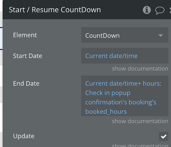

And here is how I’m displaying this countdown on the page:
I don’t’ really understand what you’re saying, or what your doing in your screenshot with the end date (that doesn’t make much sense to me).
Maybe share a link to your page and editor so it’s clear what the issue is, what you’re trying to do, and where you’re going wrong.

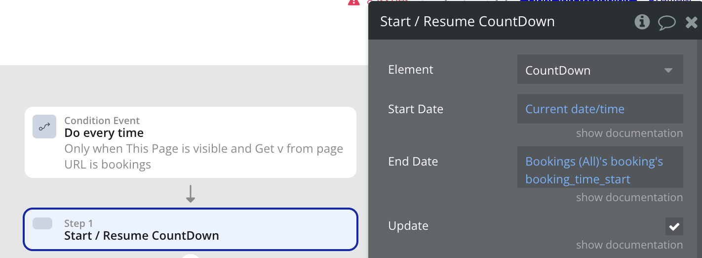

Alright guys, I m getting closer. What am I doing wrong? It’s driving me crazy.
I think part of the problem was the countdown wasn’t loading dynamically at page load. I set another trigger for that. However, now the countdown doesn’ t show up most likely because there’s nothing in it (more below).
Please note the countdown documentation says we have to ADD “something” in end date. THat’s my understanding. If I add a number 5 let’s stay after :hours instead of booking_booked_hours, the formula works, and the countdown shows and starts, however it’s not dynamic. THat doesn’t help, I do need the dynamic formula.
The debugger says the end date is empty?! Is that because the formula is wrong and it can evaluate it?
I also tried what you suggested above, one current date - static date, and still doesn’t show up

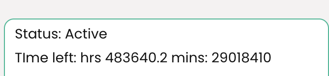

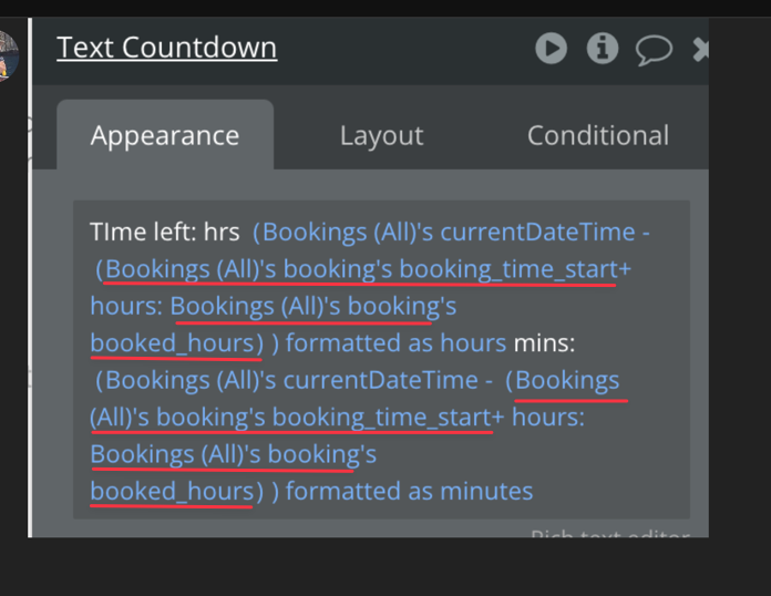

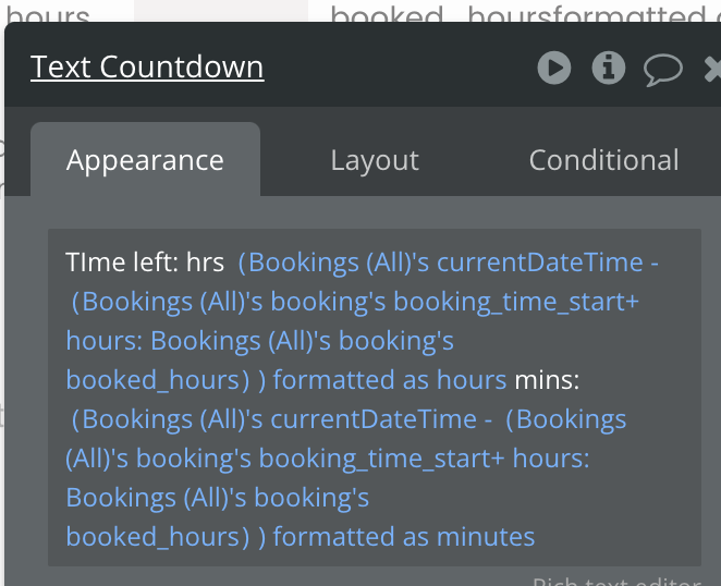

Thanks a lot Johnny! almost there. The number doesn’t look right but it seems it refreshes.
here is how it looks now and the expression i Have in the text field
and the calculation
Your custom states for the booking times might be wrong. How are you setting those? Why don’t you reference it from the database directly?
all of them except the one you mentioned “currentDateTime” (which is set as current date time in the state) are in the database. booking_start_timne is date type and booked_hours is number in the DB
They look like there’s referencing a custom state
Sorry, I don’t understand what you mean. I though currentDateTIme HAD to be a state where i set “current date time”
How are these values computed?
Also – my bad. I’m realizing it the expression should be:
(Booking start +hours: booking hours) - CurrentDateTime:formatted as hours
They’re not. they’re literally either dates or numbers. They are coming from the DB. Values and format are correct there. I checked. Booking’s (all) is a group with type of content “booking”
Ok, how are those values stored in the database? It’s hard to get the full picture with only glimpses of your app.
