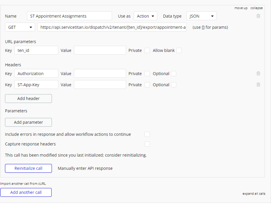

I have everything set up to this point, and Ive created an API in bubble api plugin
Ive also tried it by importing curl, and setting it up that way. Ive tried it with and without creating parameter brackets < > …etc…

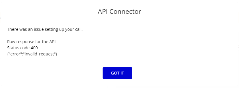

Everytime I run I get
In postman, it works fine

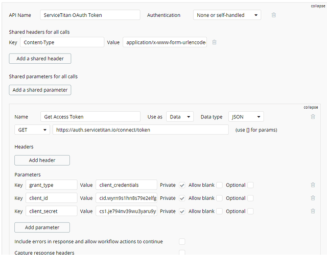

You’re passing the values as URL params i.e. https://…?grant_type=…&client_id=…
In postman, you’re passing them as data via the body. This would probably be the issue.
So yeah that screenshot was from a test changing it up but Ive done it this way, still same error
Am I missing something here?

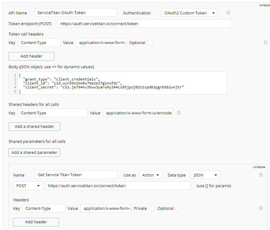

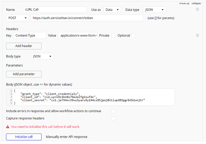

Okay so I tried something different and still getting a 400 error. Here is what I did
I created it as a custom token, I created an API call because its the only way to make action for a workflow yeah?

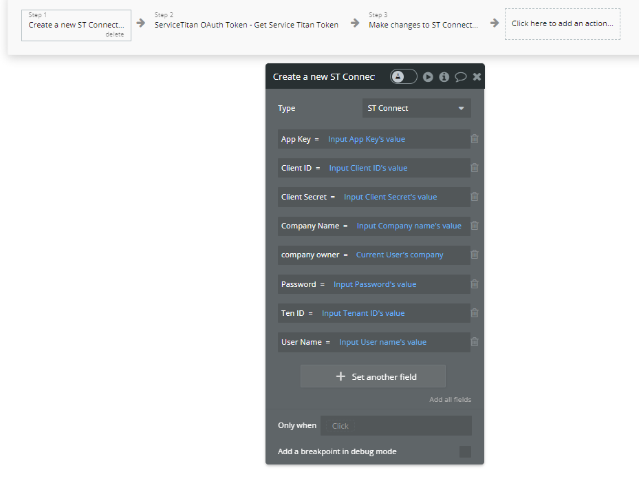

I went ahead and did a manual response with the response from postman, I went and added a workflow,

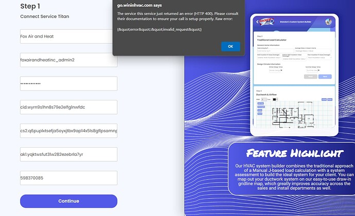

The error I get is
If I can just get the token to work, the rest of the calls I make subsequently using the token are all working. :frowning:

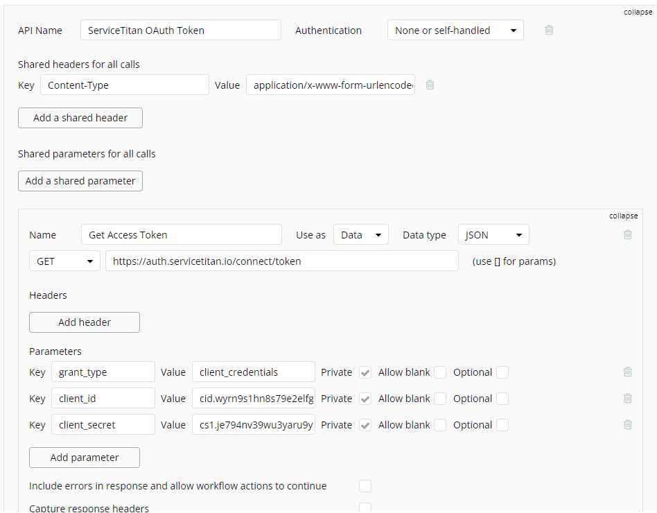

The first thing is that you should use Custom oAuth token instead of manually add the authorization token to all call. Probably you will pass the value as https://auth-integration.servicetitan.io/connect/token?grant_type=client_credentials&client_id=YOURCLIENTID&client_secret=YOURCLIENTSECRET (and maybe set the header for content-type= application/x-www-form-urlencoded (don’t use shared header but token call header. But this is probably not needed)
This way, you will not need to manually add authorization header to all call. Bubble will do it for you.
In the first screenshot, it probably didn’ work because you didn’t select POST… Also, shared header shouldn’t be set for the content-type: application/x-www-form-urlencoded. You will have a conflict with other call that will need application/json.

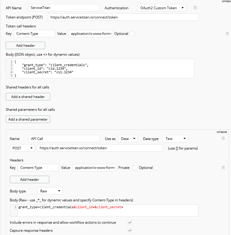

You don’t need to use an API call + custom token
Your request in oauth2 custom token section use JSON while request should be x-www-form-urlencoded. This is what you are doing in API Call (but not correcly…). You should use that in Body for token. Nothing should be dynamic with client credentials…
If it doesn’t work in body, try to put everything in the url directly like ?grant_type=client_credentials&client_id=yourclientid&client_secret=yourclientsecret

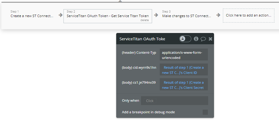

Hi thank you for your response! I have tried 3 different ways of doing this based on your recommendations:
In Token endpoint POST url:
https://auth.servicetitan.io/connect/token?grant_type=client_credentials&client_id=cid.1234&client_secret=cs1.1234
In Body:
Nothing seems to be working. Usually when I am debugging BASH curls/python requests I can at least see the form of the request as it is sent, so that I may check if there are syntax issues,. Here, however, I do not have the ability to do so here and not sure how to proceed.

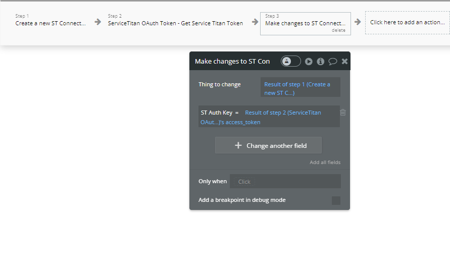

Remove the ? in body, you don’t need it. After, add an API call, not the token one. This is done by Bubble with auth. Like https://api.servicetitan.io/crm/v2/tenant/{tenant}/export/leads (Replace tenant by your value)
You can always replace url by an url from a service like requestbin to see the request sent.
