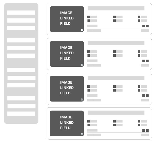

On the left column, every Dropdown is a constraint to the Repeating Group in the right. So basically you select a value on the list the Repeating Group will show the result immediately. (When the page is loaded it shows all the records because the constraints are empty - it’s my choice to be so)
On the Repeating Group (the right column), the Light Gray are text fields (in the main data type) the Dark Gray are SVG icons.

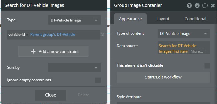

Big Dark Gray box that says Image Linked Field is a Search for and is searching the image from a linked datatype containing only images and a field linked to the Main data type. (As shown in the image below)
If I have for instance 100.000 records (multiply by 55 fields for each record) that will show on the Page Load or when the user fills the Dropdowns (still will load a few thousand)

When I say “nested searches” I am referring to a “Search for” that is needed in order to generate a constraint. Like the below… in my “Seach for X” box I have another “Search for”
What you have here is a search that needs to be executed to fill a cell in a RG. So basically, let’s say that the user ends up paging through and displaying 100 entries. Bubble will have to run 100 additional searches (one for each entry) to locate the image for each entry.
Those are all server-side searches, so only the resulting image will be downloaded. But still, it’s an inefficient and capacity-heavy approach since to show 100 entries you are asking Bubble to execute 101 server side searches (1 search for the results, plus 100 searches to fill the image fields for each result).
If each vehicle only has one image, then you could simply put a field in the vehicle record that connects to the image record. Then the RG cell only has to ask for that, and no search is executed. Or, just upload the image directly to the vehicle record. (However if you have multiple images and want to scroll them, then you may need a different approach.)
