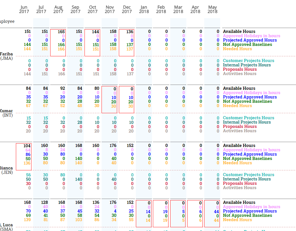

This is what I want to get. A table that shows for each month and for each employee, the following infpormation:
  • how many hours are available (search of working hours per day of the employee * working days in the month - approved holidays)
  • how many holiday booked (search of Approved holidays of the employee, in the related month)
  • Hours booked in all the projects (these data is presented in many different way, but is based alsways on searches on the same type of data (ā€œLabor Costā€) that includes field such as: employee, month, project, hours baseline, hours projected)

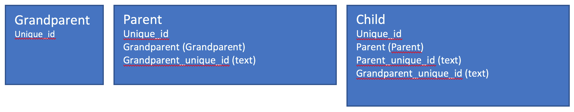

We’ve found that nested ā€œdo a search forā€s are particularly slow. While it’s typically frowned upon to duplicate fields in a database, we decided for performance reasons, we’d include the unique_id from the parent and grandparent tables in select progeny tables thereby reducing the extent of nested searches in our app. Pages that once took nearly 1min to load are now <3sec.
Specifically, this is here’s what this looks from a database-perspective.
Say you want to modify the parent table value where grandparent unique_id = 123.
Previously,
Do a search for ā€œParentā€
Grandparent = Do a search for ā€œGrandparentā€: first_item
Unique_id = 123
Now, you’ll eliminate the nested search
Grandparent_unique_id = 123
If you do this throughout the page and extend it to Child-Grandparent tables, you should see the page load is considerably faster.

so I tried to reduce the ā€œliveā€ search and calculations:
All the ā€œsearch ofā€ are performed by a scheduled API and stored in a new Type ā€œ12M reportā€.
This type has two field that work as index:
User, Month
and other fields that store all the calculated values I need to show in the report.
Problem is, in order to show, I still need a nested RG in order to create a table (horizontal for MOnths, and vertical for users).
This RG is still crazy slow to run… :frowning:
I really don’t know how to make it even more simple than that!
Something must be done wrong? Any hint?
