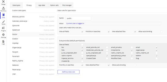

I am working on my privacy rules and recently figured out that bubble’s search shows up all data from the table (thing) (in the browser’s developer tool)…well, guess all knows about it
So, I am working on my privacy rule to set up…but have this issue - there is a field that I use in the search, but I do not want user to be able to see it…at example–user status (active, not active)…I use it in the search but not want the user to be able to view it (in the browser’s tool of course)…I am not showing it on the app screen, but it is visible in the browser background…

So have you already used the privacy rule to hide the user status? If yes, what condition did you use in the privacy rule?
yes, condition - when current user is logged in - I have view and search for all, and everyone else (that is where is the problem) - i do not want users that are not logged in to see this field, but I want to be able to show to them search results that use this field as a condition…
so, in everyone else rules - if I, for view fields turn off status, my search does not work…
any help?
Uncheck “View All Fields” and then below, check one-by-one only those fields that the user will need to see.
Keep “Find this in Searches” checked

Hi Robert,
thanks for helping…here I will post some screenshots…
CASE 1 (privacy rule and fields included for view (which I do not want) (fields are marked)
and the RG returns results.
CASE 2 - Privacy rule - fields excluded for the view (which is what I want)
but, there is no results in the RG.
