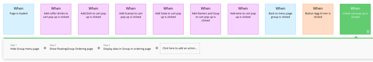

Here is how ti looks for now:

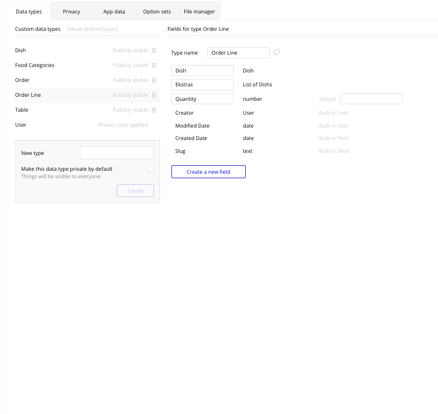

Data:

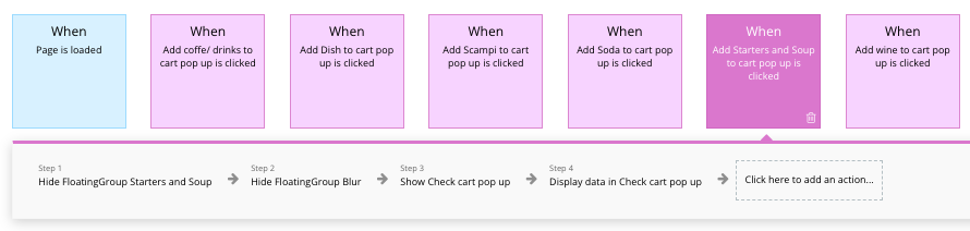

Adding to order pop up:
Navigating with order pop up information:

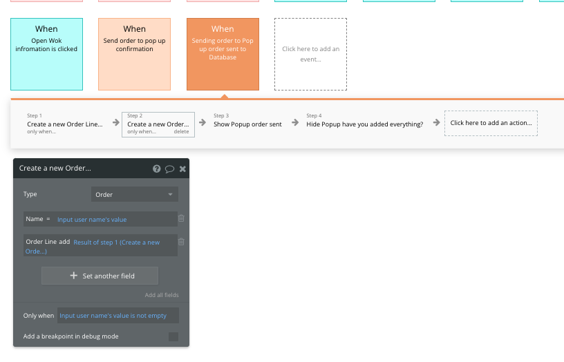

Sending the data that was selected to the kitchen:

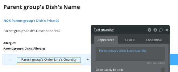

- Create a custom stare on the group or text box that displays the quantity. Let’s name that quantity and set default 1
- Create a workflow for the add and remove buttons.
- When the button is pressed, you change the said state to the state +1 or -1 depending on which button was pressed
- When the customer places an order, and you create that order line, you simply get the value of the state and voila
Just a quick tip on your workflows.
I see you have a lot of workflows for each different dish or category. I would suggest that you use repeating groups and get the information from the database (such as dish info or description etc)
is it like this you mean?
And how do i set a default a 1?
in the Data or?
You have to create a custom state for that element (the group or the text). What you are doing now is trying to get a quantity from an order line item that I assume does not exist yet. Instead this does not need to be saved as a thing and calculated purely on the frontend

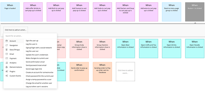

i figured out how to make a custom event with that video thanks?
Now i just don’t understand how do i make that increase and decrease with a button?
I fixed the incrementation thank you for your help!
