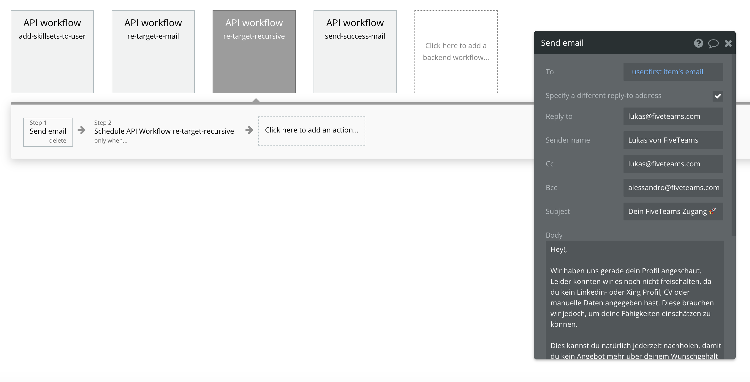

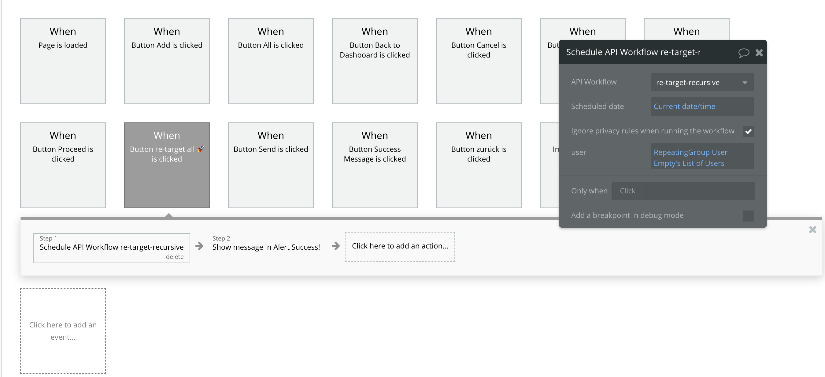

On page workflow looks like this:
The API Worklfow is designed like this:
Send EMail Workflow as part of the API Workflow looks like this:
The “recursive” API Workflow in the API Workflow looks like this:

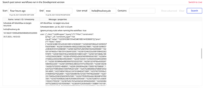

Daring a glimpse into the logs, it looks like it is triggered:
However it is not scheduled.

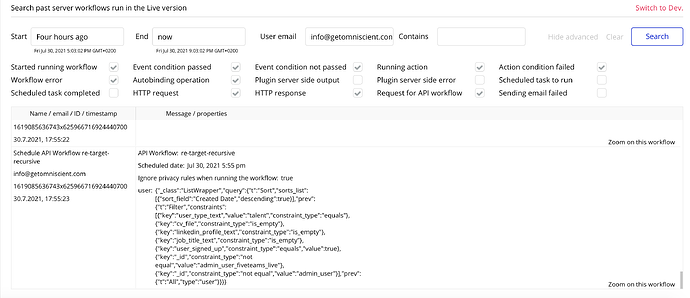

Have you dug into the logs more? Specifically:
  1. I’d be interested to see what showed up if you turned on Advanced → HTTP response.
  2. You should be able to see every step of your workflow(s), not just it being triggered.

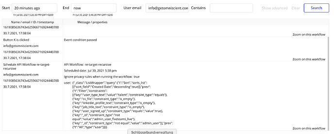

Yeah its strange. So this shows up on live version: (where its not working)

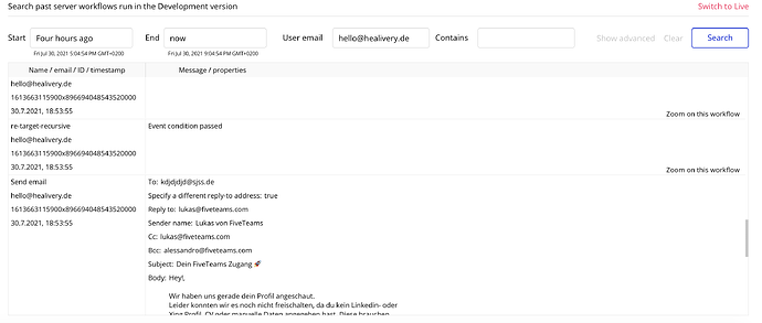

And this is how it looks in the dev version: (where its working)
