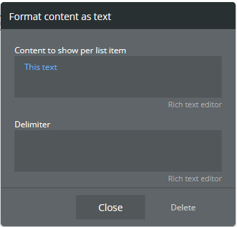

I used :extract with Regex: format as text to solve this problem. Just leave the Delimiter empty and it should return what you need.
