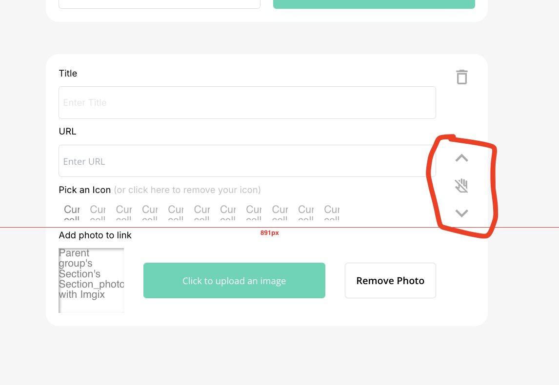

Hello!
I’m stuck a little bit :slight_smile: What is the best way (without plugins and drag and drop) how to make reorder some RB with usual “up” and “down” icons. I have tried with youtube links and so on, but mainly I will start struggling when both “links” will get same rank. I use rank to sort my list and also I cannot “end” counting the rank. If one link is first position then i can add 10x +1 rank to the first link, and then first link i have rank 11 and second one 1. So i have to limit somehow, when this link is highest in rank, stop counting sr sth,
Maybe someone can help :slight_smile:
Thanks!
