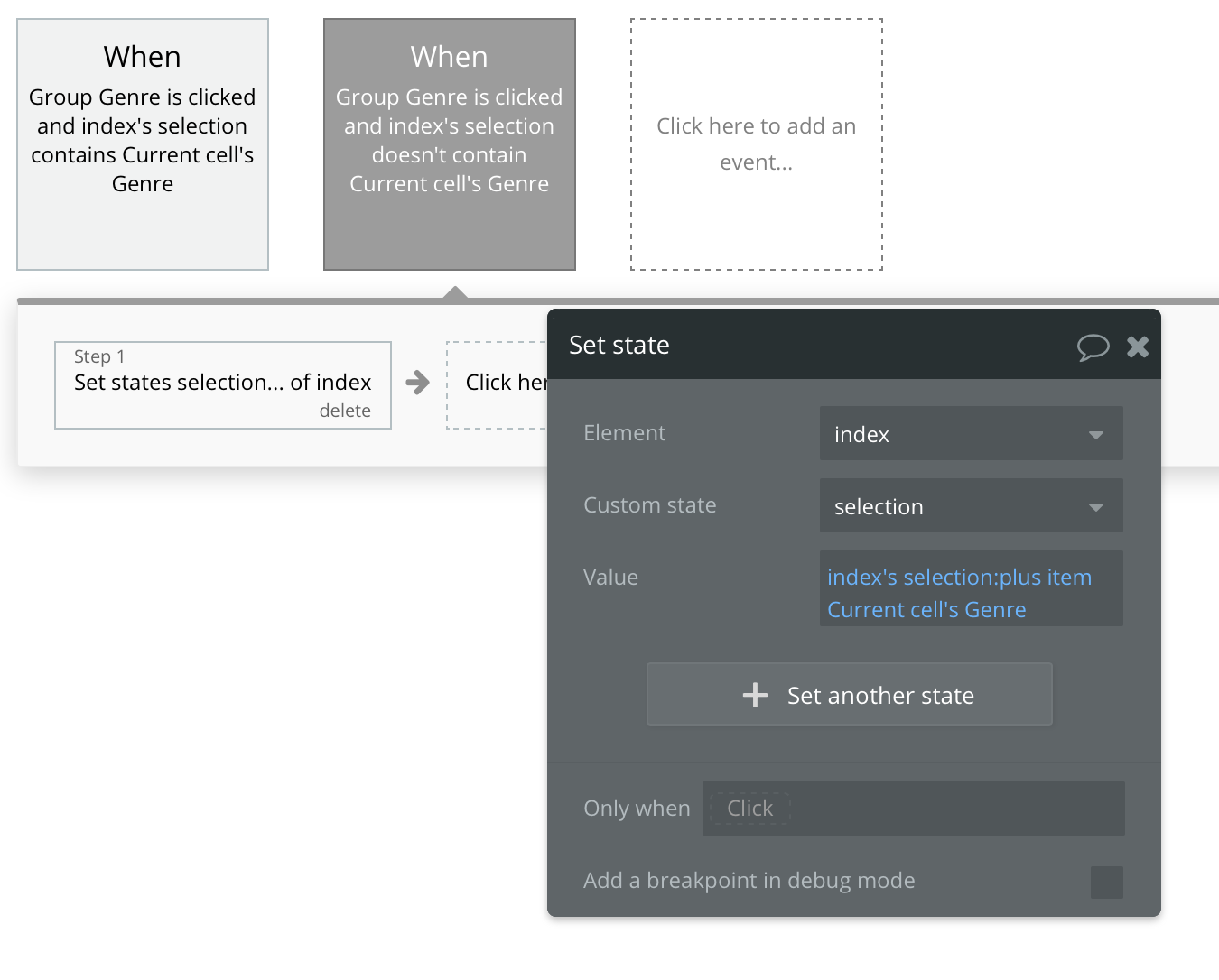

I have a page to input scripts with that I have used @gregoryjohn 's wonderful example to build a custom state to track which genre in a list of genre’s has been selected. I then successfully have been able to use a workflow in a button to save that list of genre’s to the database.
I am trying to use that similar principal to use the selected genre’s on a search page to dynamically filter the search results in a repeating group. I realize the custom state is creating a list so maybe it isn’t possible but I wondered if there was a way that the repeating group can recognize the text in the list and use it to filter the search?

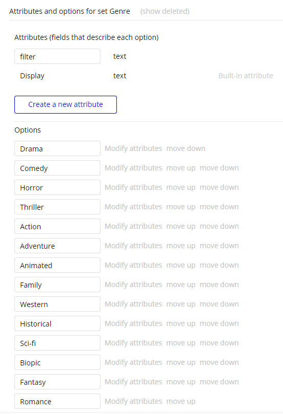

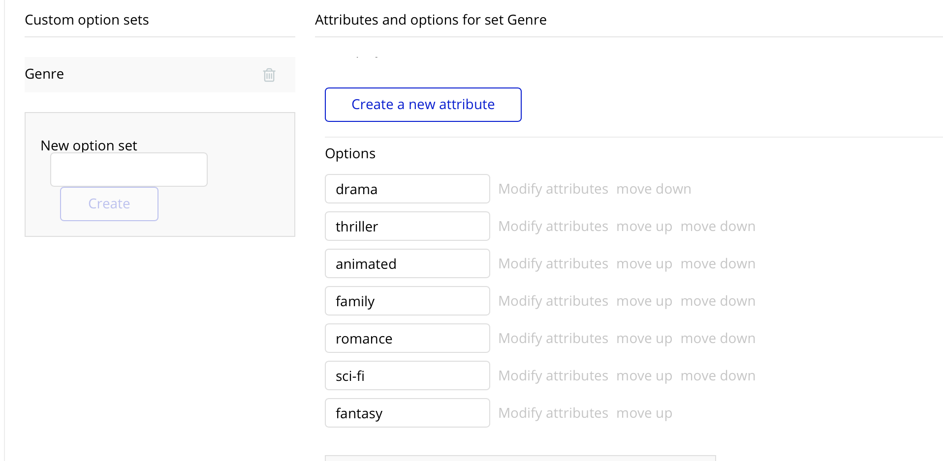

and my genre option set

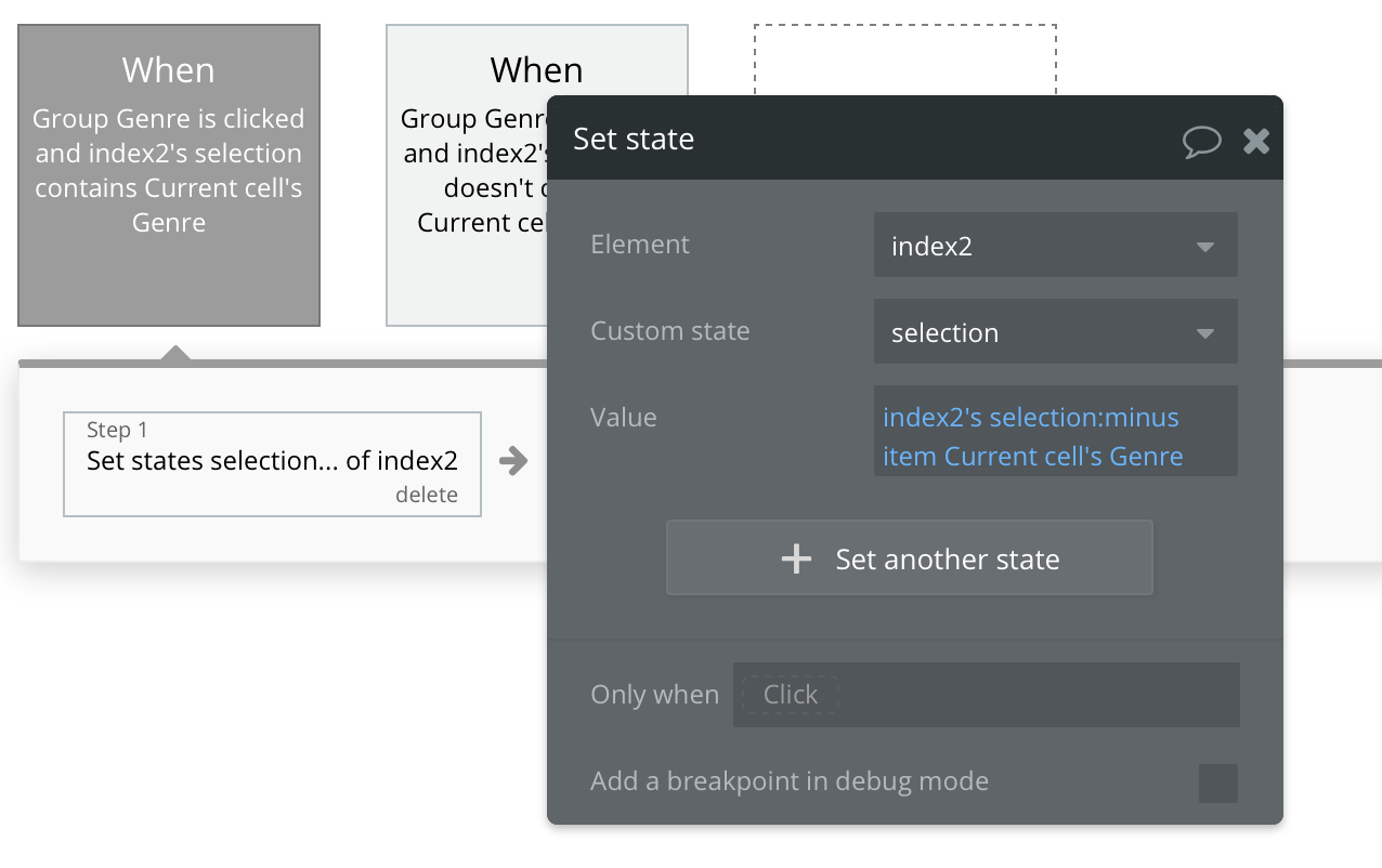

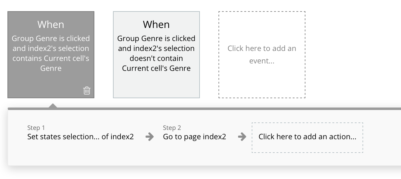

2 ways to solve:
  1. custom state lists and option set lists (no URL parameters)
  2. URL parameters (I have probably done a slight mashup of @boston85719 early and later techniques)
To save time recreated a piece of your database as follows:

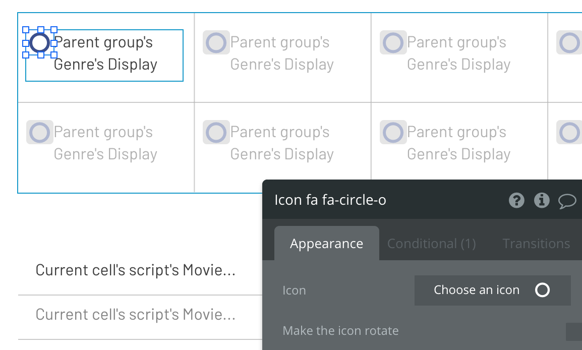

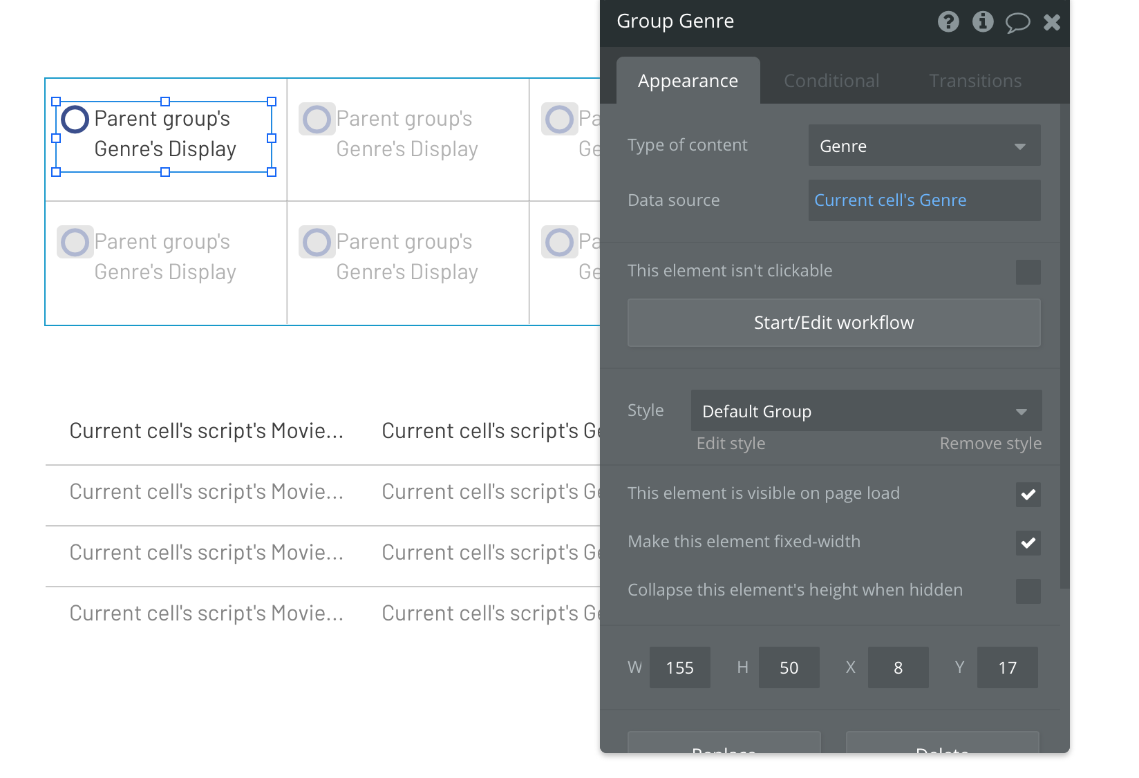

Created 2 RG’s on page: 1 for filter, 1 for displaying results - note data types on each ie filter is using ā€œoption set listā€ and displaying results is using "script datatype from DB)

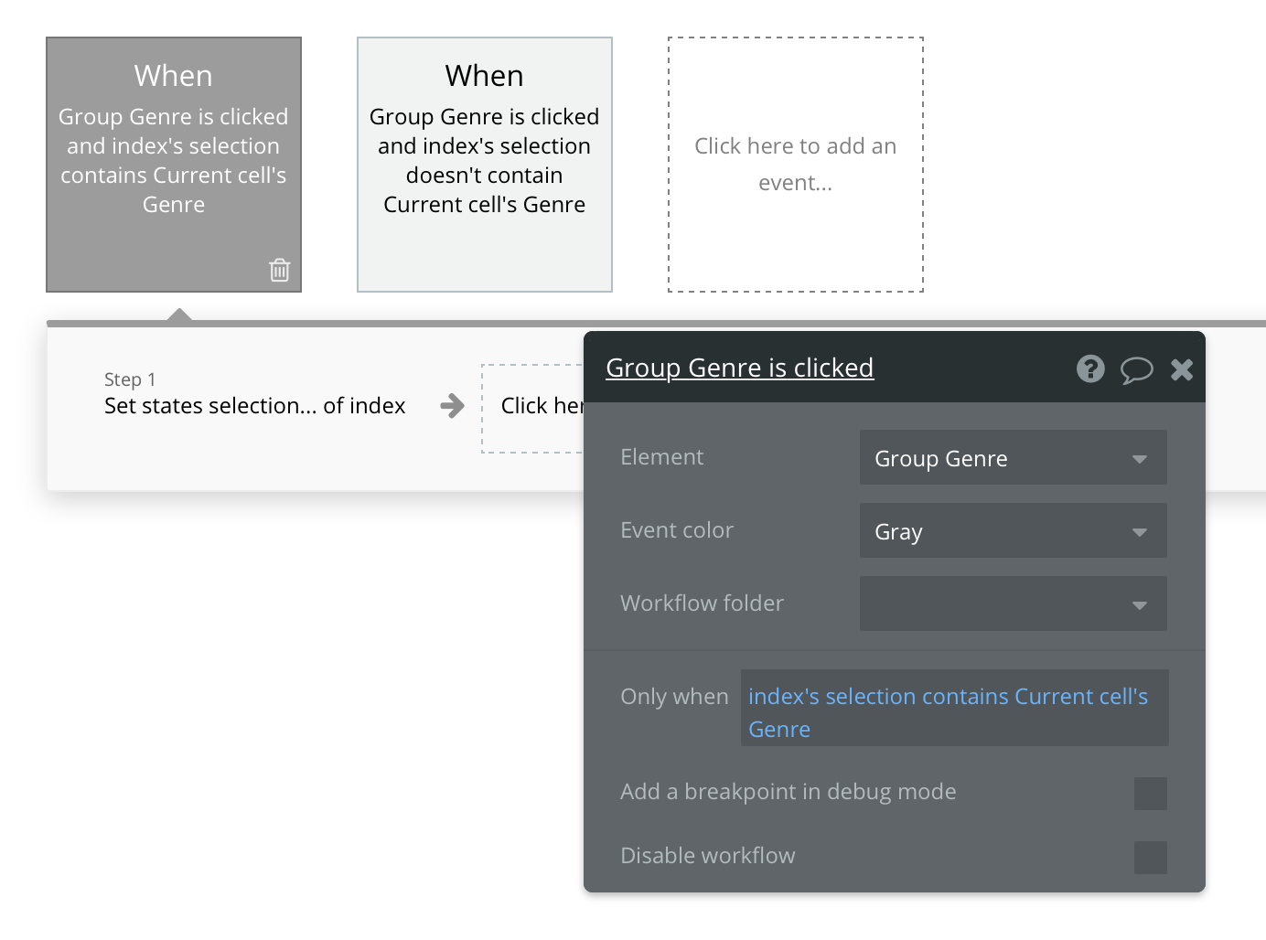

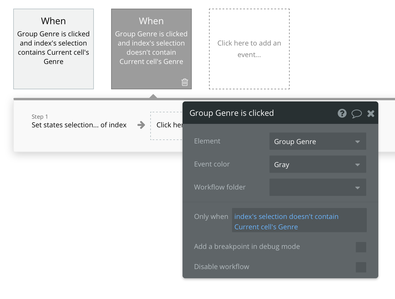

Let’s fo to filter first… have an icon and text in a group in the RG. Set states on these…

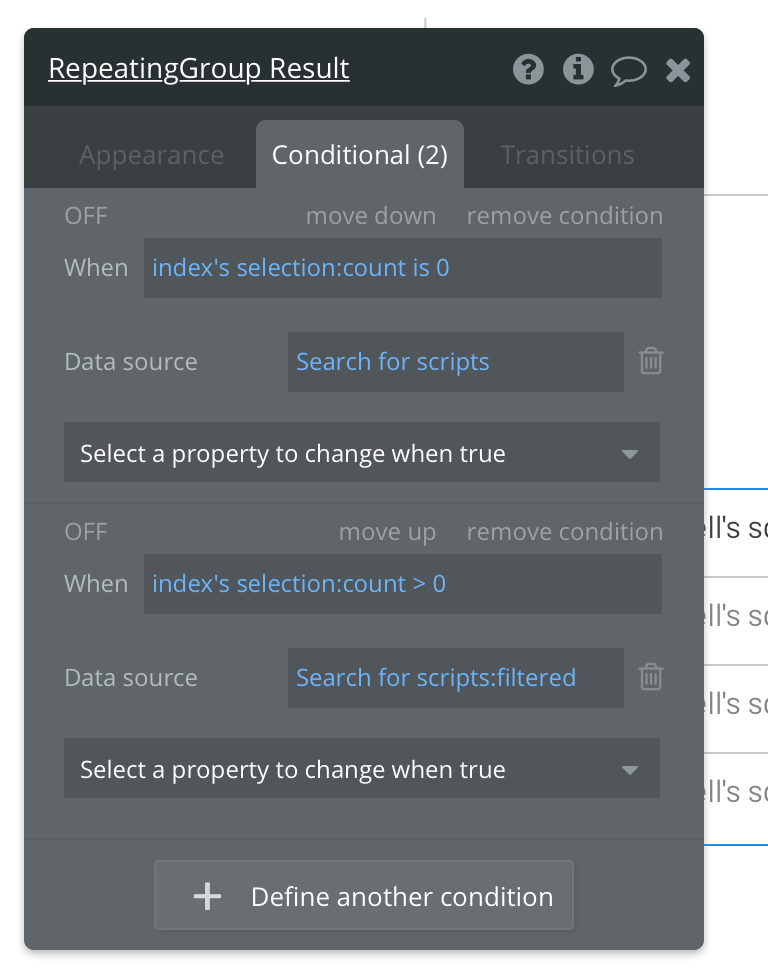

Then moving onto RG set which data to search based on what conditions your have in conditions. You can NOT filter a list where the list can bring multiple answers on the search side. You typically have to filter ie ā€œdo a search for:filterā€ and used an ā€œadvancedā€ expression.
In this case count=0 is saying there is nothing there, while count >0 is saying there is at least one filter chose. Notice also that sometimes you might want to ignore empty constraints - ie let people not fill out question. You can ignore or include constraints on your search as well as on your filters. As far as the filter itself you essentially need to compare the row in DB against the custom state list. In this example I am using ā€œcontains listā€ to force an "and type answer ie the RG would only show answers where all the checkbox apply. If you were going for an ā€œorā€ answer you would use ā€œintersects withā€. So my expression is "Advanced = this ā€œDB datatypeā€ ā€œdata fieldā€ ā€œcontains listā€ ā€œcustom states elementā€ ā€œcustom stateā€.

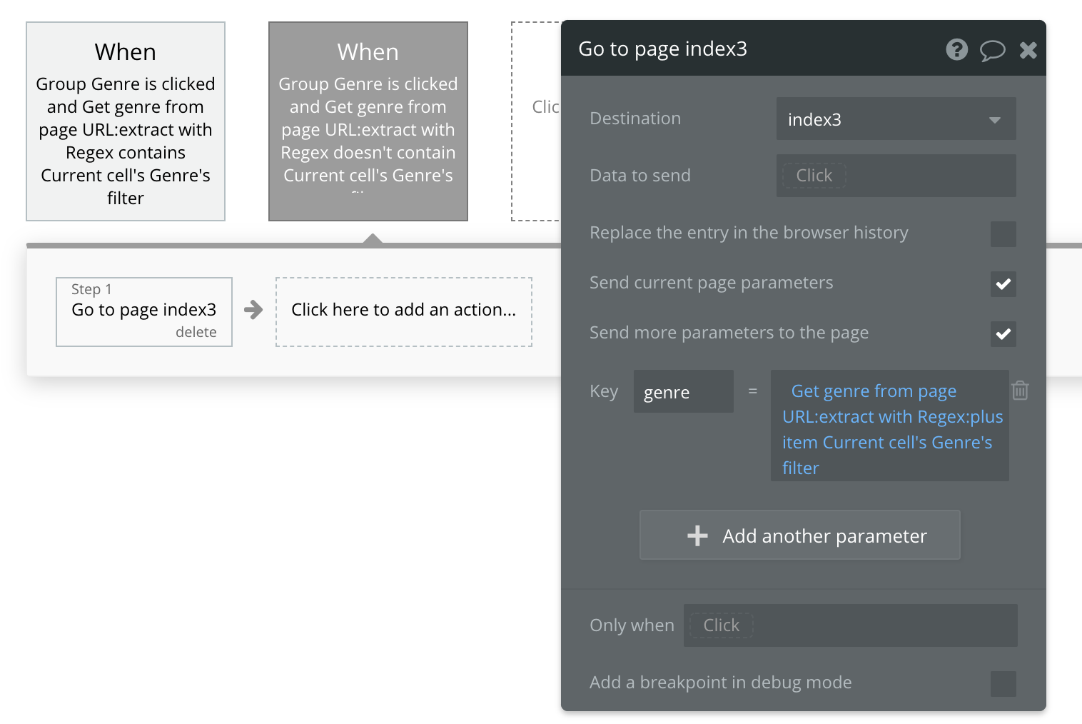

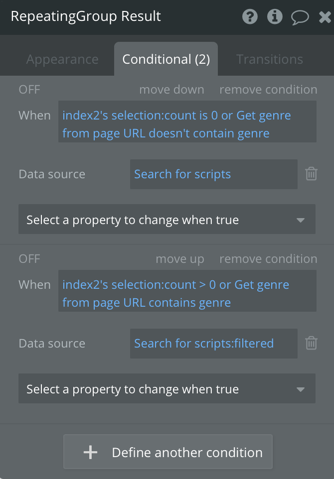

Moving onto URLs and parameters… much of course is the same - here are screen shots showing where the workflow is different. Essentially genre (key) = ā€œcustom states elementā€ā€œcustom stateā€ā€œoption sets attributeā€. Easiest thing is to set this to ā€œfilterā€ per @boston85719 suggestion and make sure to use lower case and treat it like a slug. Slugs have to be lowercase to work.
Then on the RG itself the conditional filters change to account for the fact you are now comparing the DB to URL parameters instead of custom state list.

Thank you so much for taking the time. The step I was missing in both cases was setting the conditional on the repeating group result. And thus the list filter expression needed. I was mistaken setting the ignore empty constraints was enough. What I’m unclear on with the conditionals why does the count matter? Is that what gives the ability to filter? I’ll have decide if there is benefit to having url parameters over the custom states. But having a clear option between the two is super helpful.
@jbleroux - In the URL example I didn’t need to have both when statements - ie both count equals and URL equals but wrote out both to show you options. The count in custom state examples was needed in the conditional for it to determine when to run each search. Think of it this way maybe - when count=0 essentially it means when nothing is checked and no choice is listed in the custom state list do search x (basic search showing everything because I am not filtering) and when the count>0 at least one thing has been checked and at least one choice is listed in the custom state do search z (which involves this additional info ie the filter).

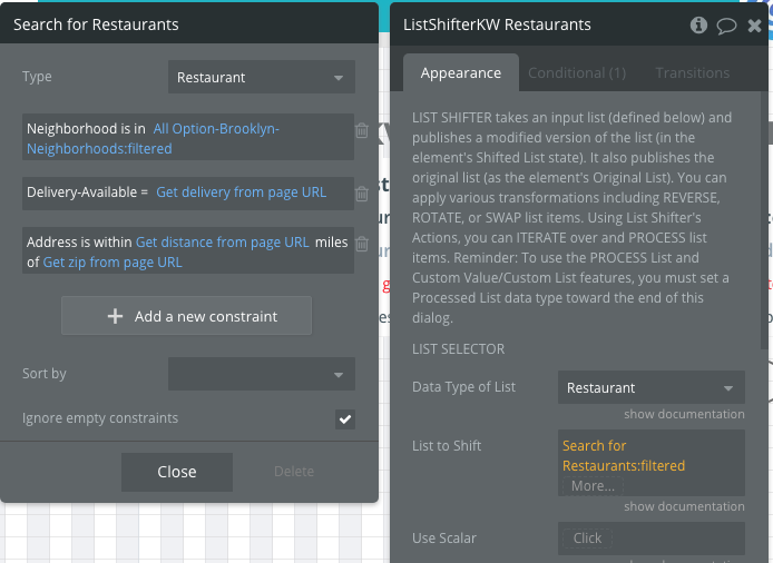

Here are screen shots of how I have a search set up
Screen Shot 2021-03-25 at 10.25.57 PM
The conditional is only based on if they want to search the restaurants that are in their favorite list, so I put a conditional to grab their favorites list instead of the entire database of restaurants.

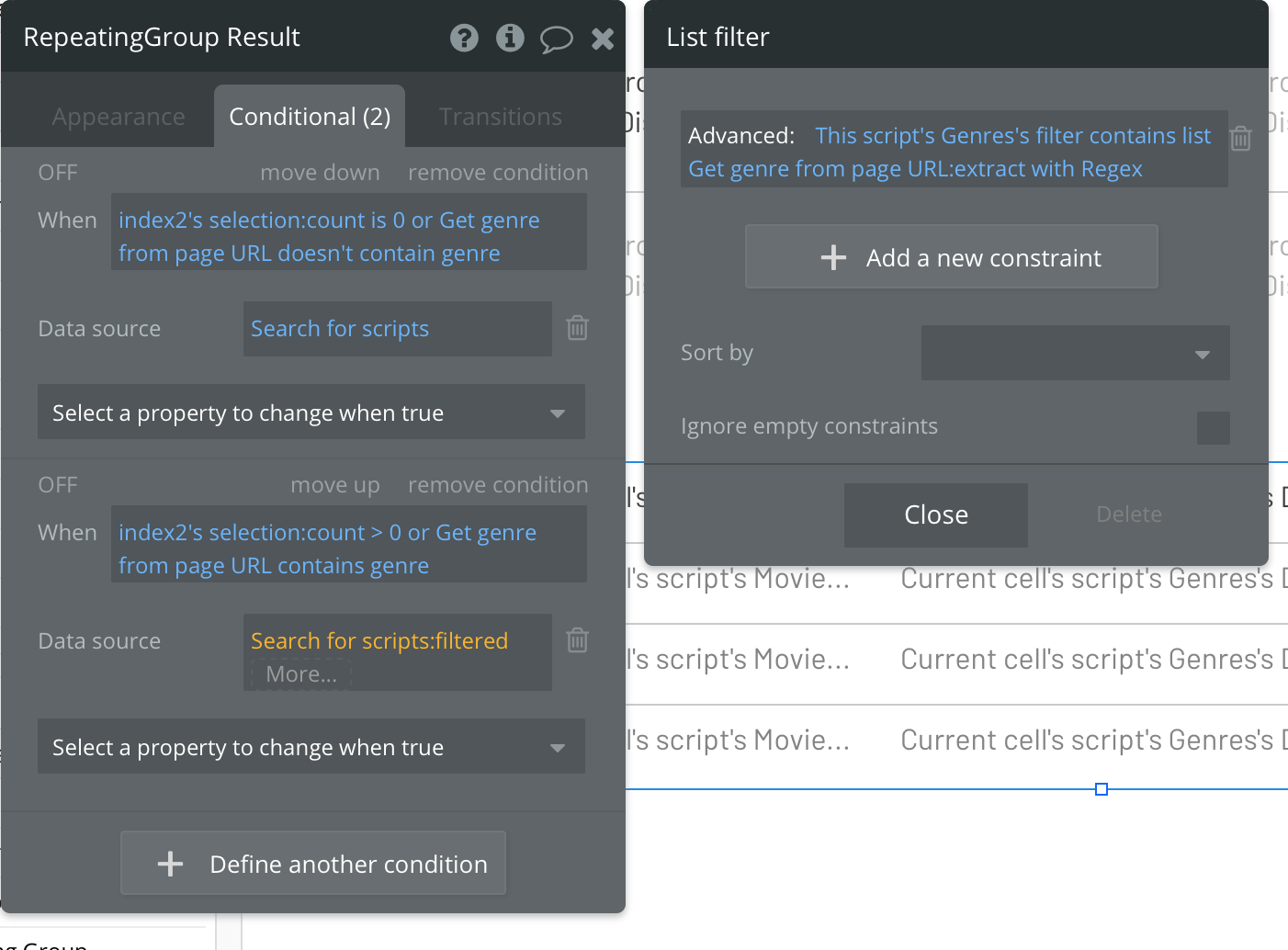

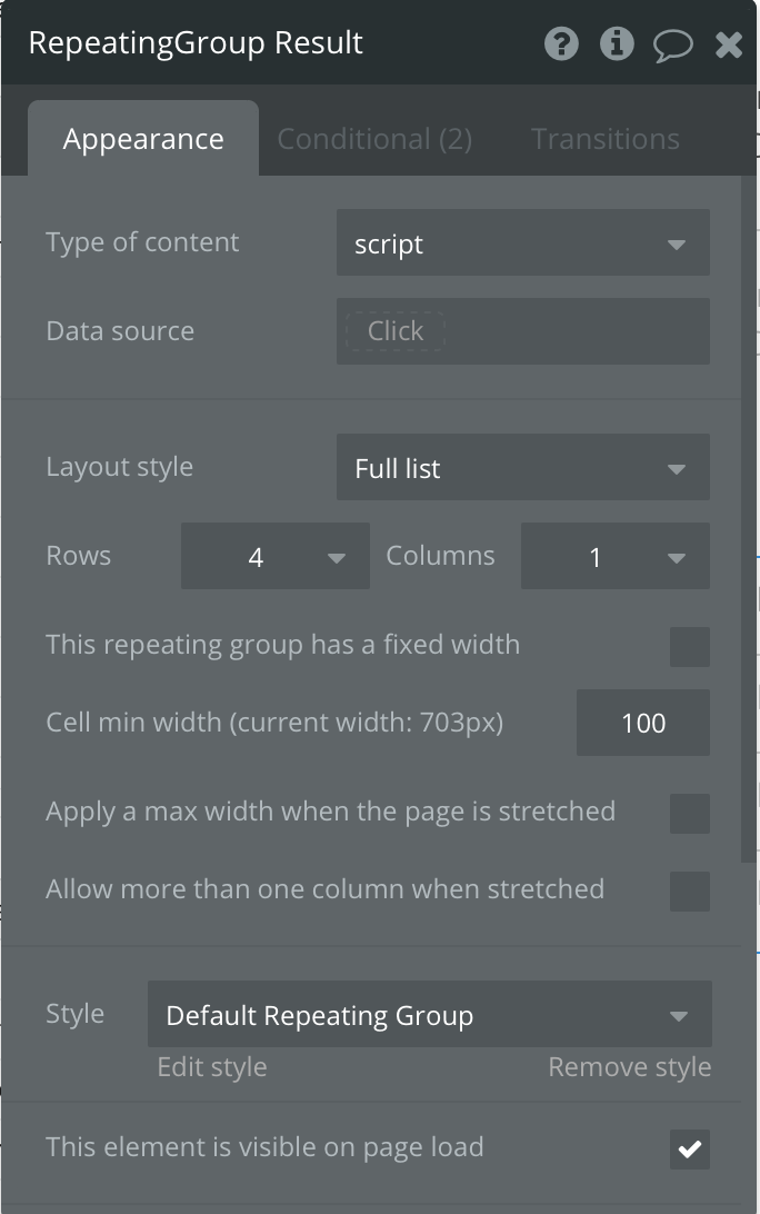

I think the first half or 3/4’s of the steps are fine. I can create the workflow to click the box which in turn sets the URL parameter and can see the results in the URL. I’m stuck at the repeating group search results. I have copied the steps laid out in the images from The RepeatingGroup Result from @ccabaj but I do not get the option to select a data source. I’m not sure where that comes from. image image I appreciate the notification about the update @boston85719 because I read the update as an add on not as a replacement for. It is unfortunate that bubble won’t let you edit the post because it probably would help simplify the process. For this run-through I am following @ccabaj 's instructions in this post for URL parameters to see if I can get it working before I switch up the methods. Is the List Shifter in the images above a plugin?
Hi @jbleroux .
So if you are getting data from a data source you need a link to it. Option 1: 1 main data source on ā€œfirst page of editorā€. Second option as part of conditions like this… by clicking on ā€œselecting on property to change when trueā€ - and selecting data source. There you will need to do a search for - select script and click on the more button. This will bring you to filter where you can write advanced expression. You may need to play around with your when statement depending on what you have done as well as ignore or include constraints (by checking or not checking that box).

b. using custom states and URL parameters (a mashup of @boston85719 earlier and later methods) so thought I’d better sort out a clean ā€œno custom statesā€ and URL parameter method (ie try to replicate @boston85719 later method). I may still have done it a tad differently …
Here are the screen shots using same database for third version:
Hopefully this doesn’t cause confusion but in this version I simply used only one data source (ie no conditions) - as I believe the Regex is taking care of a number of things (contains/doesn’t contain) and the URL instructs what I need. There would be other instances when you would want to use a conditional including a when and varying data sources.
@ccabaj Thank you, thank you, thank you. I appreciate you taking all the time and I will be sure to pay it forward when I can. I have used the search for data source before and filtered the search with all the dropdowns but because I was following step by step I didn’t want to do anything to screw it up. It works and further-more I understand how it works. I’m sure the conditionals add more complexity if needed but simplicity is the name of the game with this app. Now I can go through and do this URL parameter method for all the filters. The URL parameters might even be overkill right now, but they will make scaling much easier in the future. Going through this process with you and @boston85719 has also helped me understand the way Bubble structures the statements better so hopefully I can figure out more of them in the future on my own. Thanks again.
