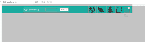

You might be aware that a Reusable Element has an issue about responsiveness when you try to hide it.
Basically let’s say when you go under 800px of page width, you’d like to hide your reusable element.
Well wether you’ll “add a hiding rule” from Responsive section (in Design) tab or use a condition on that element or trigger an Event “Do when Current page width<800”, it will still take up the same space as when it was visible:

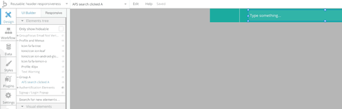

And a trick to solve that is to use a group as a container:
I spend almost 2 days on trying to figure this out… So I hope it will help some people !

Did you try putting the reusable element in a group, and then adding a hiding condition for the group?
Yes indeed that’s the whole point I tried to share here :slight_smile:
