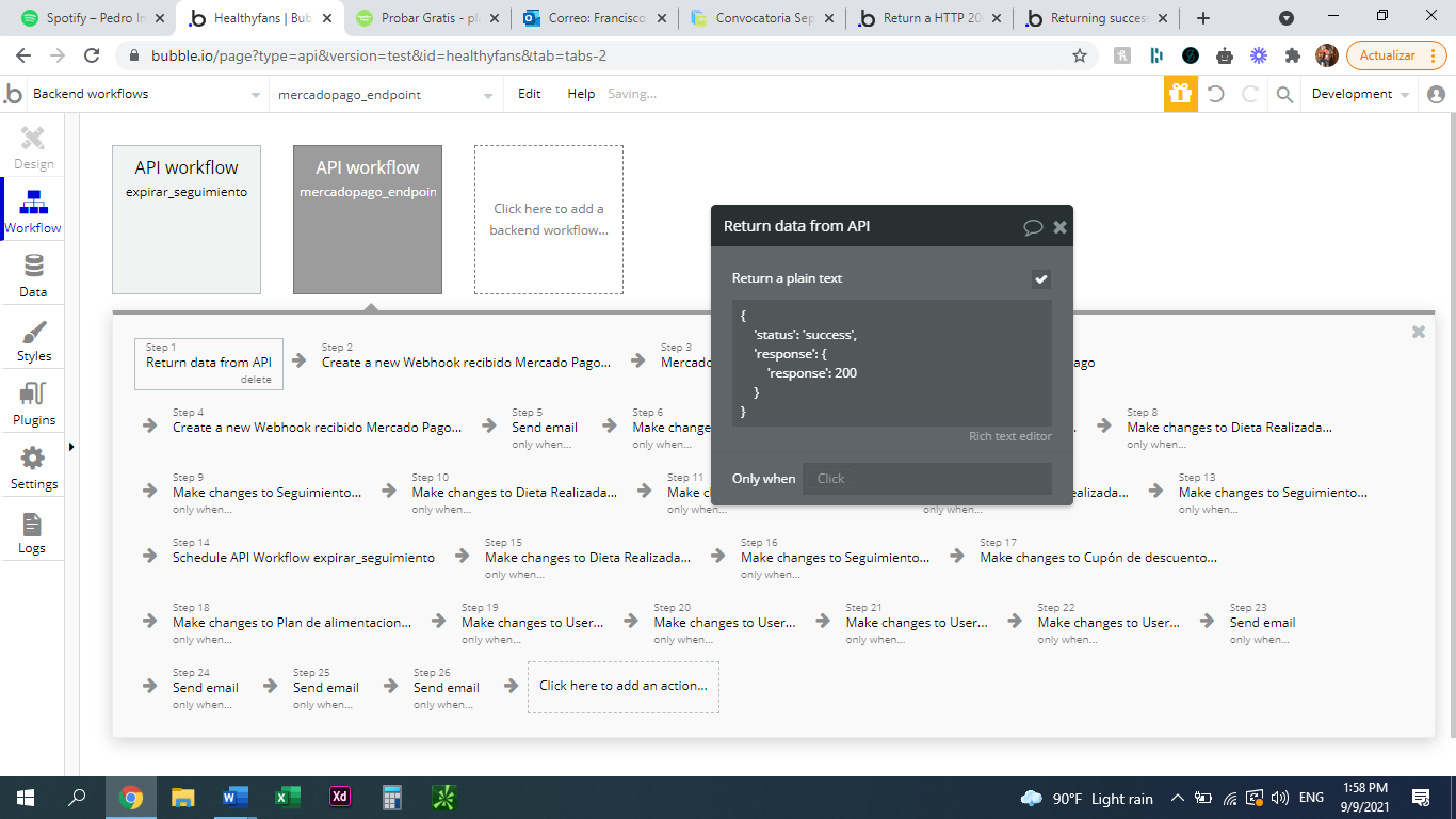

I tried this:

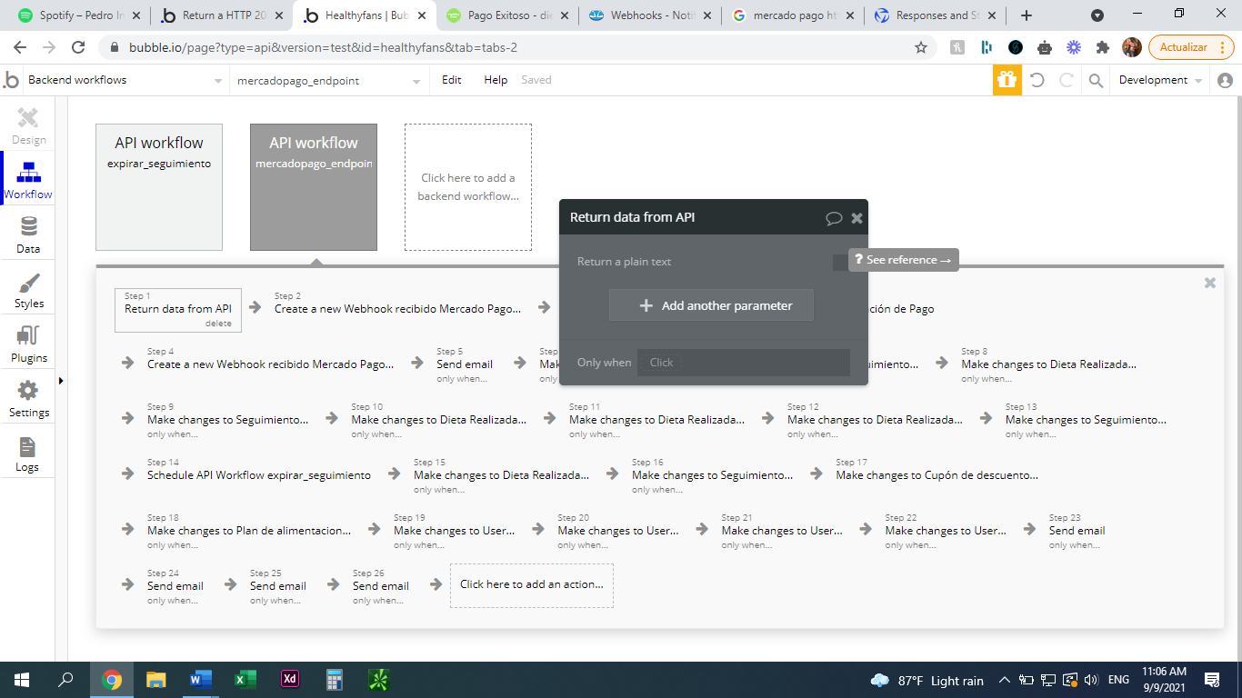

I tried also this:

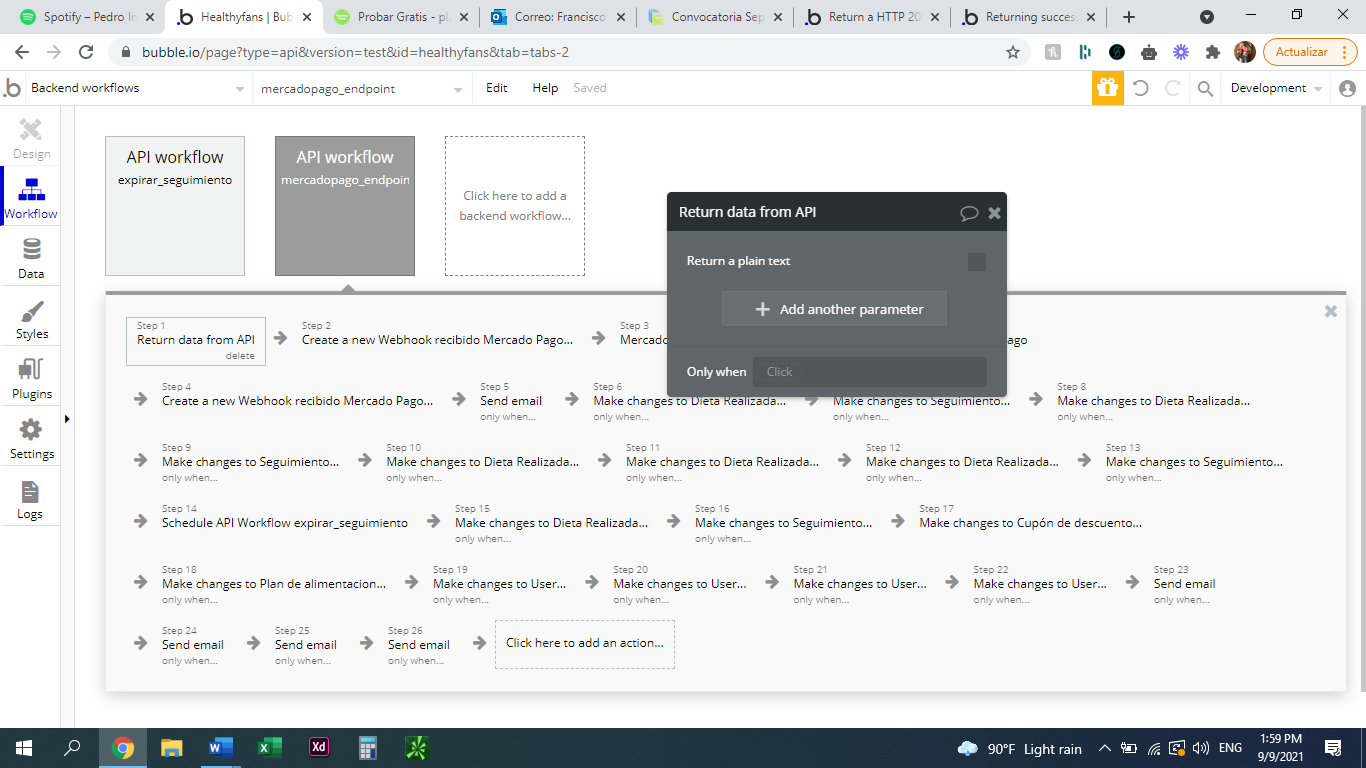

And also tried this:
None of them have worked, so I keep receiving the same webhook notification many times (if I don’t respond with a HTTP 200 it keeps retrying)
