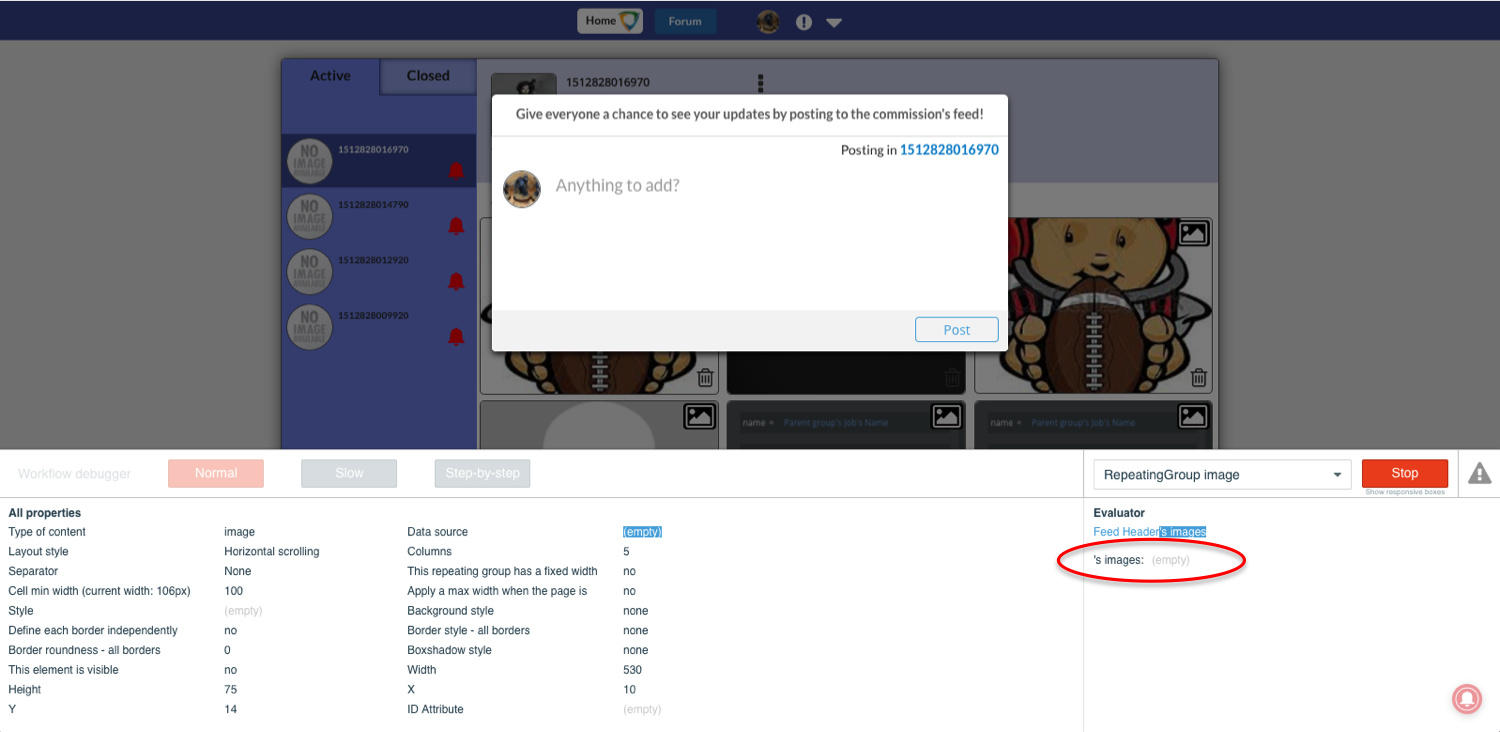

I also checked out the elements in debug mode and everything looks like it should work:
Custom state:
The custom state is being populated properly with a list of images.
Repeating group:
The repeating group is properly set to display the list of images in the custom state. However, it shows the list of images as empty.
