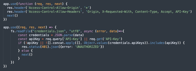

I am not understanding how you are having an issue in calling google cloud functions to run with authentication. Here is an example of how I pass an API-Key or it will respond with a 401 code and say unauthorized but that’s only because I added the code for that.
If I understand correctly, your access to API is public in Google cloud meaning set to ā€œAllUsersā€ and then you are managing the authentication via code.
