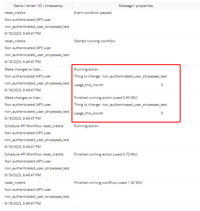

  1. The server logs in bubble. They show that the workflow only ran once. Here’s an example:
  2. I check the user database. There, once the user’s “usage_this_month” has been set to 0, I manually change it to some random number like 777, save it then refresh the database every few seconds to see if that number was reset to 0, which it wasn’t.
Your screenshot clearly shows the workflow rescheduling itself….
Lol you’re right. It’s my first time looking at server logs so I was just looking for what I wanted to see (the usage_this_month value changing), wasn’t sure how to read them initially. The problem was with the first screenshot I posted:
I set User to “Currrent User” when it should’ve been the Result of step 1 :sweat_smile: it works now that I changed it. Thanks both @mikeloc @adamhholmes
