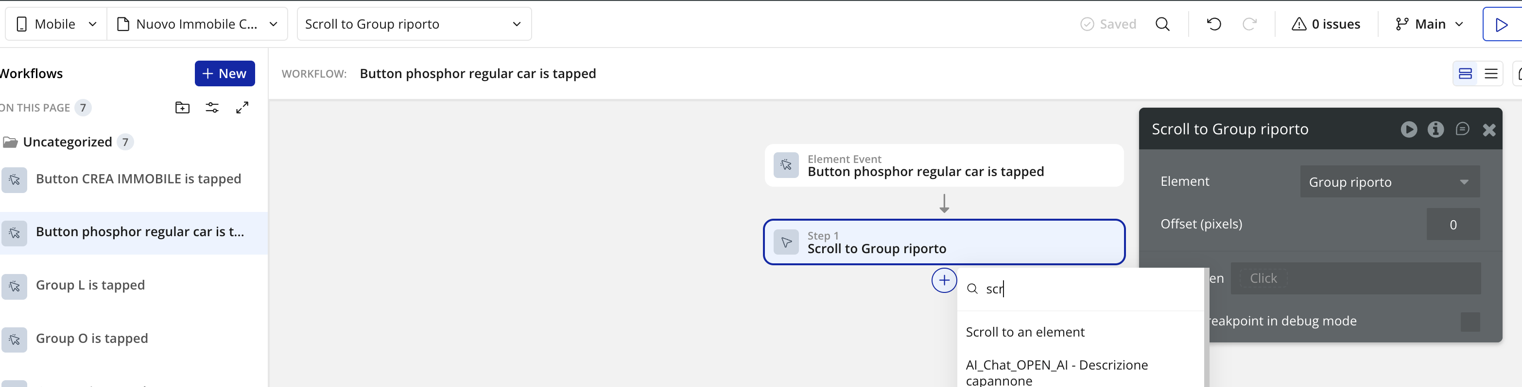

Hi, I don’t think it’s possible at the moment. But for a similar thing I used the scroll to action, which points to a group that I placed at the bottom of the page, about 1 px high so as not to create visual defects. It works for me, I hope it can help you :slight_smile:

Sorry but where do you find this Scroll to action? it doesn’t appear on Mobile beta for me
Try typing scroll should definitely appear.. :slight_smile:
In my case, I don’t have this option.
I think you are on Web.

No, I’m on mobile and by the way I have the app on the stores.. @fede.bubble how do you explain this?
@mario11 Which bubble engine version is your app currently running on? mine is 29
Maybe this is it
I definitely see “scroll to an element” in my WFs for a mobile app as well
My bad, my view was set to vertical list. I changed it to Scrollable type.
