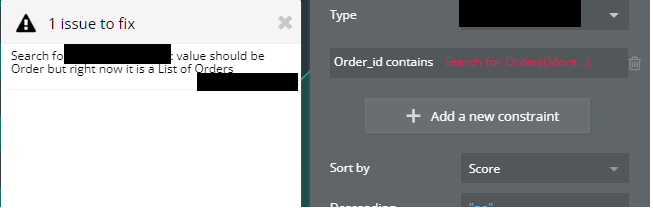

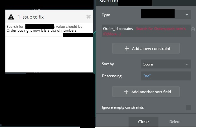

Well here is the problem, as I have tried this.
As a search for IDs or a search for orders themselves.
They are stored as a list of orders but nevertheless I cannot look up those items.

“Order_id” field is the type Order, or is it text? Also looks like it is a list field? I didn’t think of that.
If your 2nd datatype “Order_id” field is a List of Orders (Order datatype)
Search for (your 2nd datatype):filtered, then do Advanced: This Order's Order_id intersects with Do a search for Order (then put all your date/time constraints in this nested search):count > 0
Hopefully your database isn’t huge because this is a client-side search, you may see a small hiccup while it uses the Advanced filter…
It’s because it’s comparing lists to lists and checking if it has at least 1…
If your database is huge you may want to consider restructuring.
