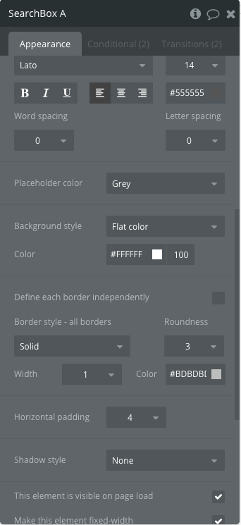

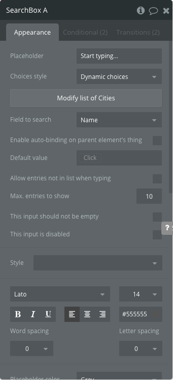

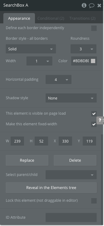

Searchbox highlight color
Seems like there is currently no way to choose the color that is used to highlight the selected or hovered value from the search box
Screen Shot 2020-08-29 at 9.30.47 PM
Or is there a way to change that blue color?
I don’t see any selection available to make.
Does anybody know of some custom code to change it?
