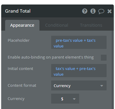

Hello, I have a form with some user inputs and I managed to get some calculation done. E.g. Item, price as inputs and I derived the total. I also calculated taxes in a separate field. Now I just need to do the final sum of the products and taxes. I can’t achieve this on the same form - may be something very simply but I have spent considerable amount of time trying different things but no success.
In other words I am trying to do a sum of two derived values on the same form. I am trying to accomplish this thing in elements. Alternatively, paranthesis if supported will make my life easy.

Vincent, I tried moving that grand total field to a different group but still no fix. It shows 0 total - which tells me that the iterative calculation that needs to happen is not happening. Bubble is so popular and I am sure there is some fix. Some ideas would help here how to deal with this very very basic issue.
Would be easier if you could share your edito or the problem
Here is a simplified version.
See the Qty. * price - gives the sub-total. There are two items fields for now. the pre-tax sub-total doesn’t get populated, so as tax and grand total. tax I just hard-coded 10% but still no luck.
It looks like these computations need to happen in an iterative manner in order for it work, just not sure how to accomplish this.

Also, it helps to not put the values in the placeholder :stuck_out_tongue:

I may be misunderstanding … but you can do the maths in “initial value”.
Nigel, yep. That fixed the problem. I was not placing this calculation in the initial content - I was just doing it in the placeholder section. But as soon as I modified in my App - I see proper calculation shows up.
Awesome thing. Now I can focus on moving forward :smiley:
