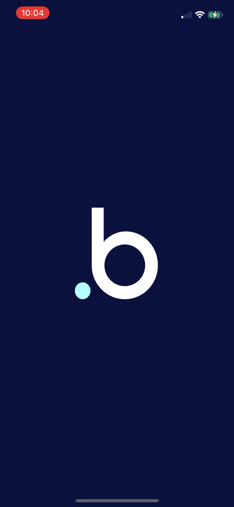

Here is what I was able to build so far:
