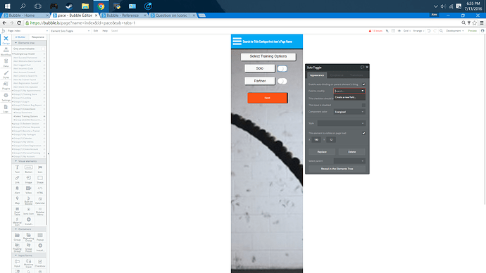

I have a page where the user has some options and a configuration item is generated based on their selections
As an example I have an option that says “solo” along with a toggle to turn the option on or off
What I expected was that I would assign the “solo” variable the Boolean value of the toggle, but my selections are “checked” and “not checked”.
So here’s what I did:

Wow, I had not taken a close look at auto-bind, very cool.
One question, When i go to select the field I would like to auto-bind, the options dont include my already created fields. instead I get the option to “create a field”
What am i missing?

nvm, it was a data privacy issue. Thanks @csblack!
Hi, I have the same issue and also checked my privacy… all the right boxes are ticked too…
I only have this issue with ionic toggle or radio button or checkboxes. Is it because the data type in the database is a number and not a yes/no?
Answer is yes! Needs to be a yes/No. That is resolved. But haven’t been able to get the totals yet…
