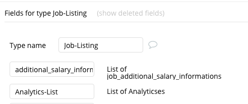

I have a job listing data type. It has a data field which is a list of ‘Analytics’.

Here you can see the job listing has a field that is a list of ‘analytics’ which is about 100 times slower to load.
