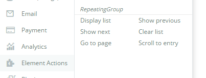

Or use the “Display List” action to show the list you want based on the button click.

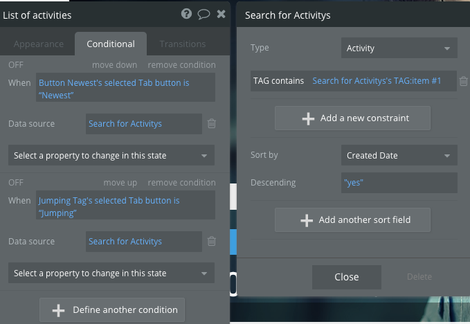

…and I spoke too soon… Little problem… When I toggle between, in this case… “Newest” and “Jumping” The repeating box doesn’t seem to reset… So, it the works first time you click on it… but after 2nd time, it doesn’t work… it just get stuck on Jumping… which only shows 1 listing… not sure what the problem is…
it looks like when you are setting the custom states, you are applying them to different elements - they should be the same element with a different state. I usually set a state on the Parent Group or the Page’s Group, not a custom state for an individual button.
So when you click “Newest” it changes the data set, but when you click “Jumping” it is changing the state of a separate element. Your first element is still in the “Newest” state.

Yep! That seemed to have fixed the problem. Thanks, guys!
