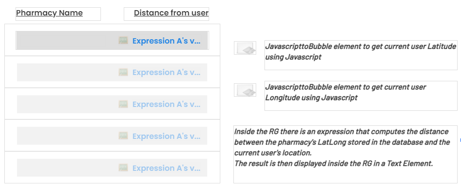

Hi guys
Is there any way I could use List Shifter (or any other solution) to sort a RG by a text element which value does not come from the database.
pharma1
I’d like to sort the RG by distance. The distance does not come from the database but from an expression placed in the RG cell.
