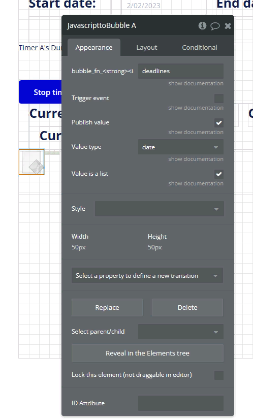

In addition, I will show how to use the Tollbox plugin, specifically its “javascript to Bubble” element and the “Run Javascript” action.

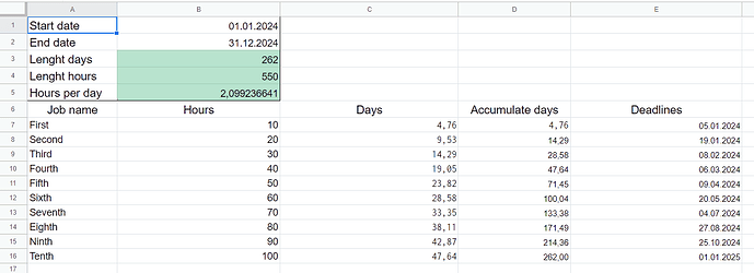

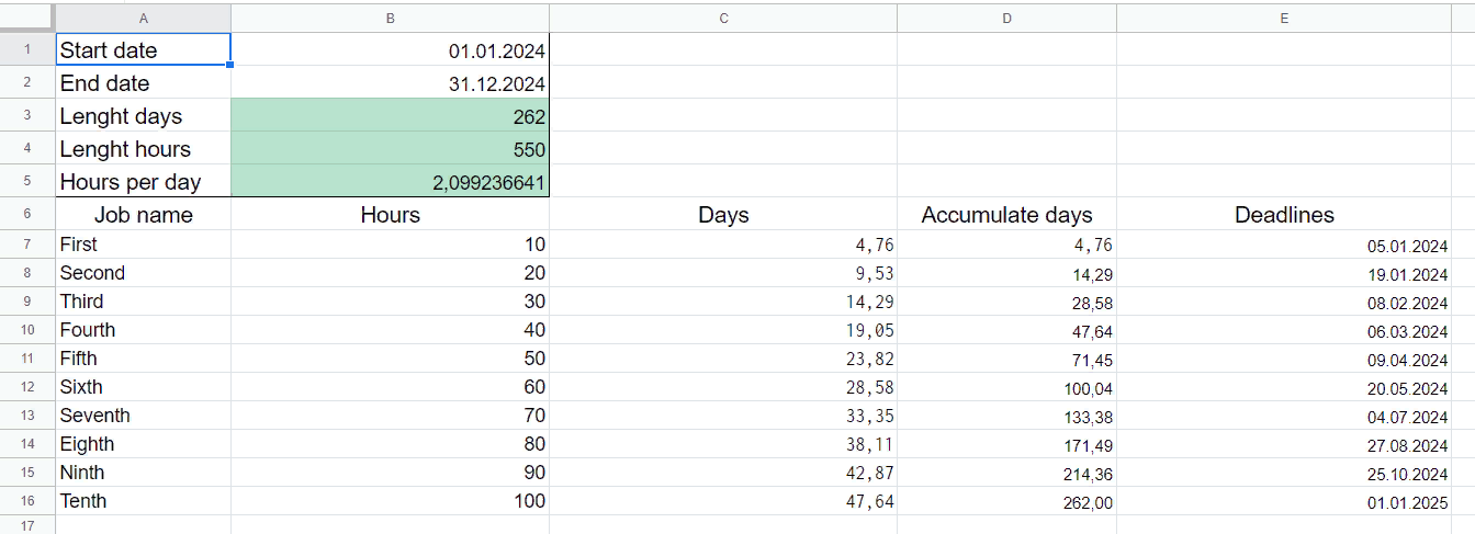

As references, I was provided with a table:

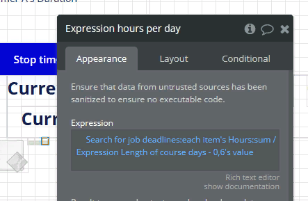

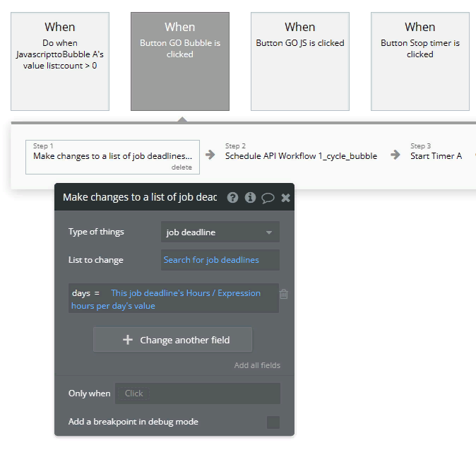

Before calculating the deadlines, it’s necessary to calculate the number of days required for each task. To do this, we’ll immediately find the “k” coefficient of the number of hours per day that the hours need to be divided into to get the number of days:
Solution with native bubble tools:

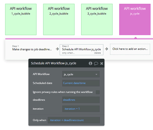

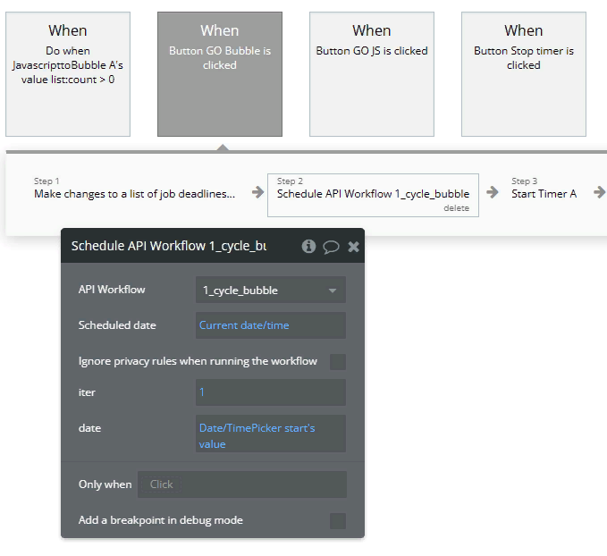

Next, we pass the hours array and start date to the back end loop:

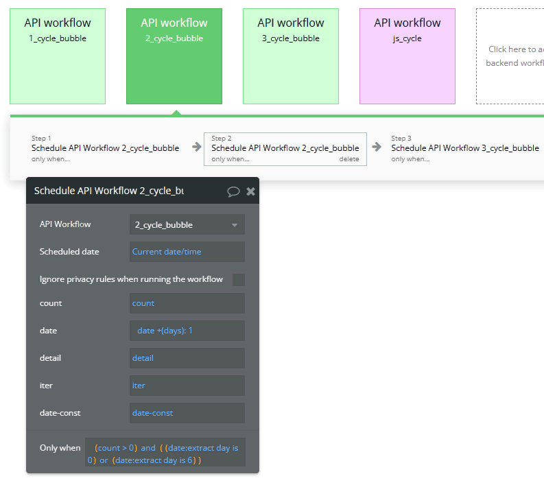

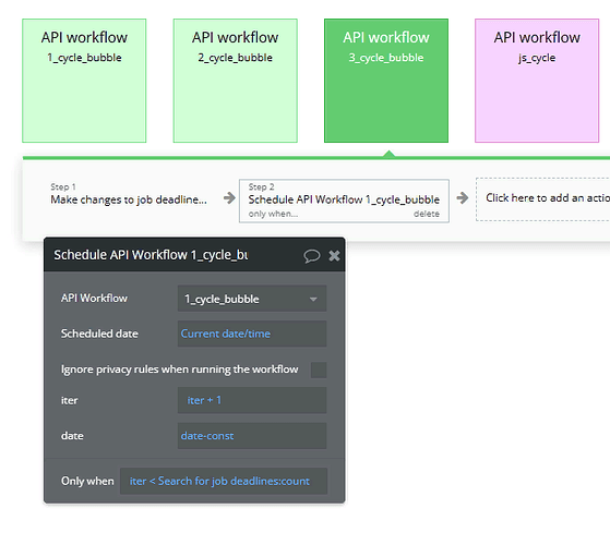

In the loop, in turn, starting from the first job (the first value of the days array), we start another cycle:
In the second cycle, using the iteration method, starting from start date, we add one day each and check whether the new day is a weekend (you can also check whether it is not contained in the holidays array):
If the conditions are met, then we subtract 1 from the first number from the days array and restart the cycle, otherwise we simply restart the cycle. We do this until the number becomes = 0.
When the number of days has become = 0, we write the resulting date as the deadline for the first work and run the next iteration, where we will work with the next number from the days array, adding all the previous ones to it, the starting date remains the same.

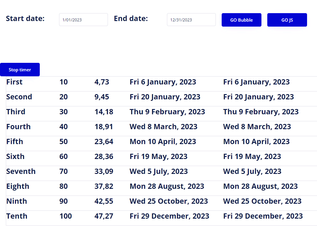

Thus, we get a cycle within a cycle. The speed of calculating deadlines for 10 works with a total duration of a year, I detected on the timer. It took a little less than 5 minutes for the backend of the bubble.io While the JS script has only about 8 seconds, and this is taking into account the cycle that, after executing the script, made entries to the table for some time. In fact, the script is executed almost instantly. left column bubble, right column JS

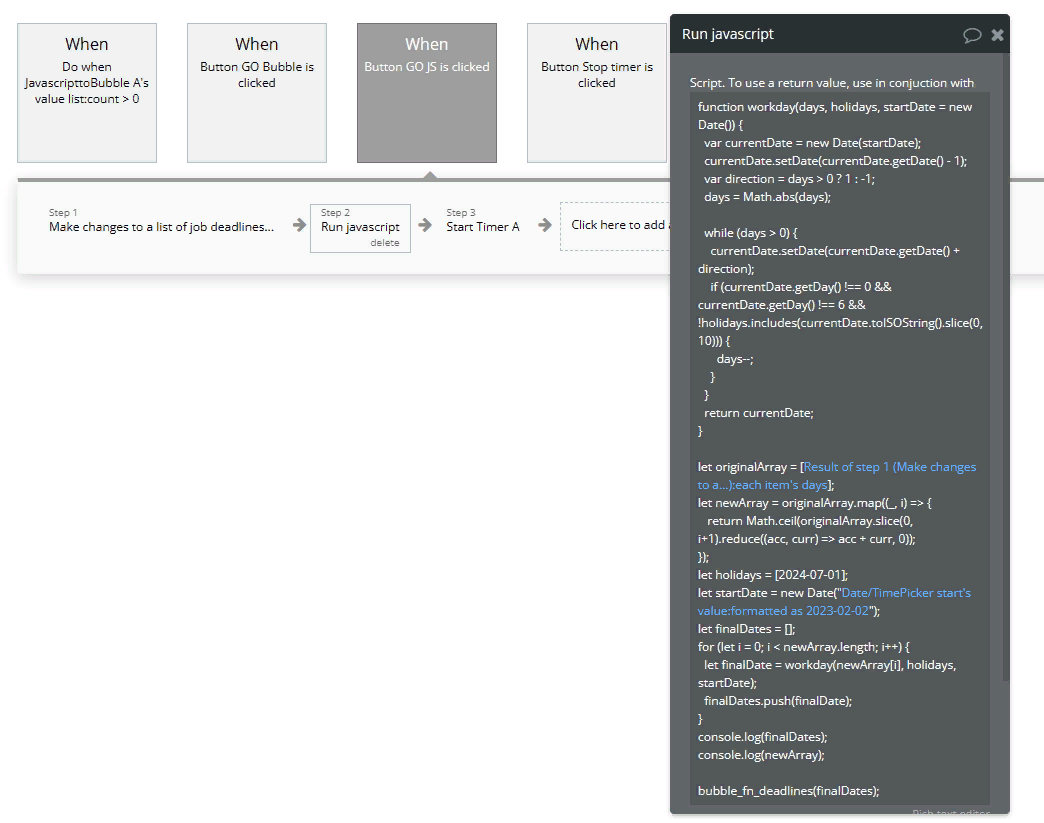

Solution using JS:
I think there is no need to add anything here, you can see everything in the screenshots. By the way, there is a more accurate way to count the working days between two dates, this can also be done using JS (write in the comments if interested).
