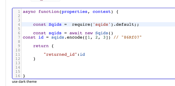

@michael.fielding this is what you need to do.
context.v3 is deprecated.
Ssa are commonjs, therefore you can only use require and dynamic import.
You can see what kind of module is provided by a library from its package.json, this library provides both types.
Once you require/import the module you need to know if you need the default export or a named export.
const Sqids = require("sqids").default is what you need.
This is basic stuff about modules that usually is handled by your tooling of choice. Because with ssa there isn’t a build step you need to understand at least the basic about how modules works.
If you are unsure about how to use a module you can test it locally with node v18, just install the dependency and execute a file with your logic. It’s quicker than trying stuff with ssa.
