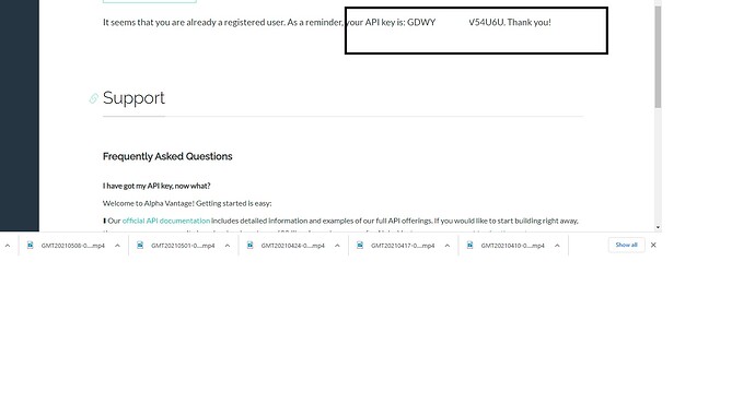

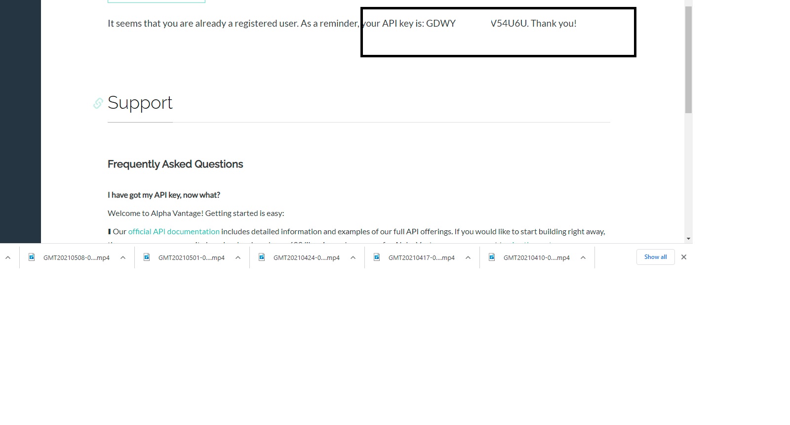

I am too following your session. where do we get to enter the API key from Alphaadvantage?

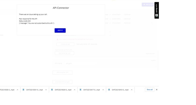

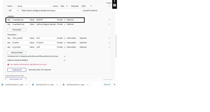

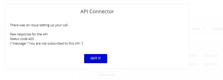

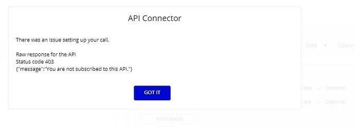

I’ve tried to configure as per the snapshot. it gives me error 403 upon initializing the API. Can you please help to resolve?
Thanks
Hi @ajitsahu2,
You’re setup looks almost correct. I think you want to remove the API_KEY header from the query call, and use the x-rapidapi-key in the shared headers. So replace the bdfa… value with your GDWY… key.
Let us know if that works!
Hi launchable,
Idid try as per your suggestion by re-placing the x-rapidapi-key value with GDWY… Still getting the same error.

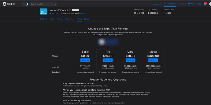

It looks like you haven’t subscribed the the API. If you open the RapidAPI site, and go to the AlphaVantage page, you can select “Pricing”, and from there register for the Basic plan (see attached screenshot; this is the Yahoo Finance API, but it’s the same structure). Once you’re subscribed, you can make calls. I would recommend trying a couple within the RapidAPI dashboard first, to make sure you have access.
Cheers

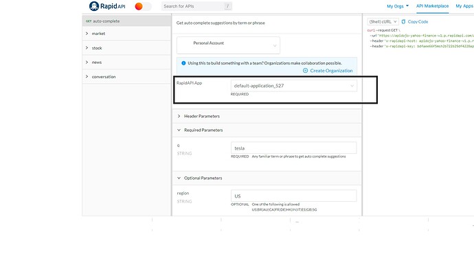

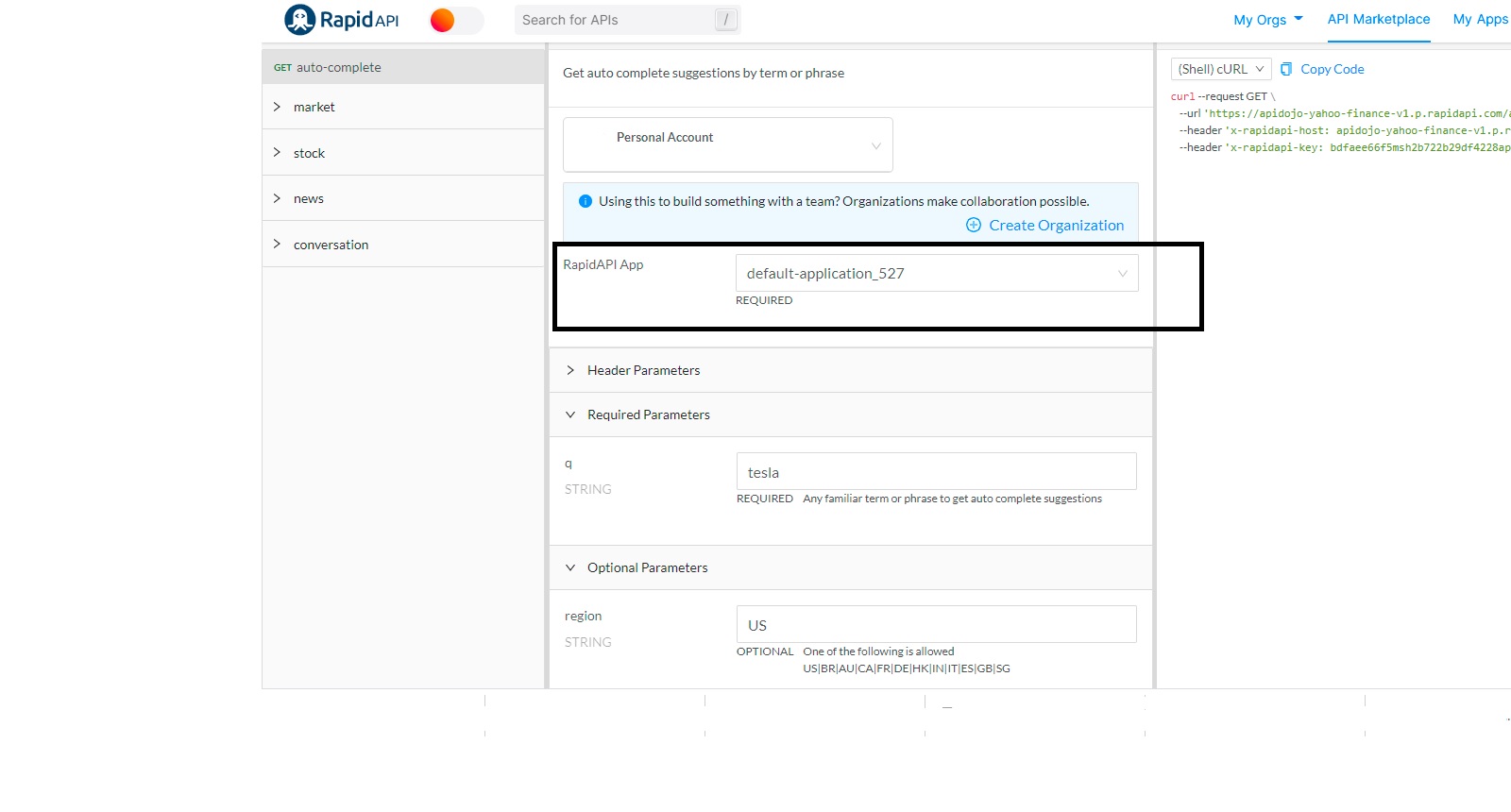

Thanks, I am now giving it a try with Yahoo Finance: Where do this field go in bubble API connector?
Got the API to work, thanks. Still curious about the usage of the field RapidAPI app
Whoops, missed this, sorry. Glad you got it working!
I don’t think you need the RapidAPI app identifier in your Bubble connection. You need x-rapidapi-host and xrapid-api-key headers, but I believe the RapidAPI App ID refers to an app that you have defined in your RapidAPI dashboard (I’d think, e.g., for project management, usage tracking, etc). I’d have to double check this in the docs though, so take this with a grain of salt.
