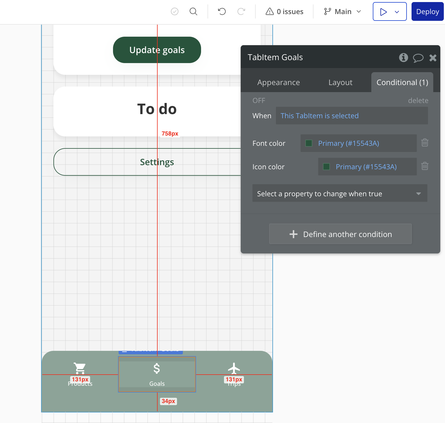

Using “The tab item is selected” should work when the a tab item is the current view. Can you confirm that you have setup something like this on your tab items?
Thanks for the response!
Confirmed I have a similar setup, heres what mine looks like:

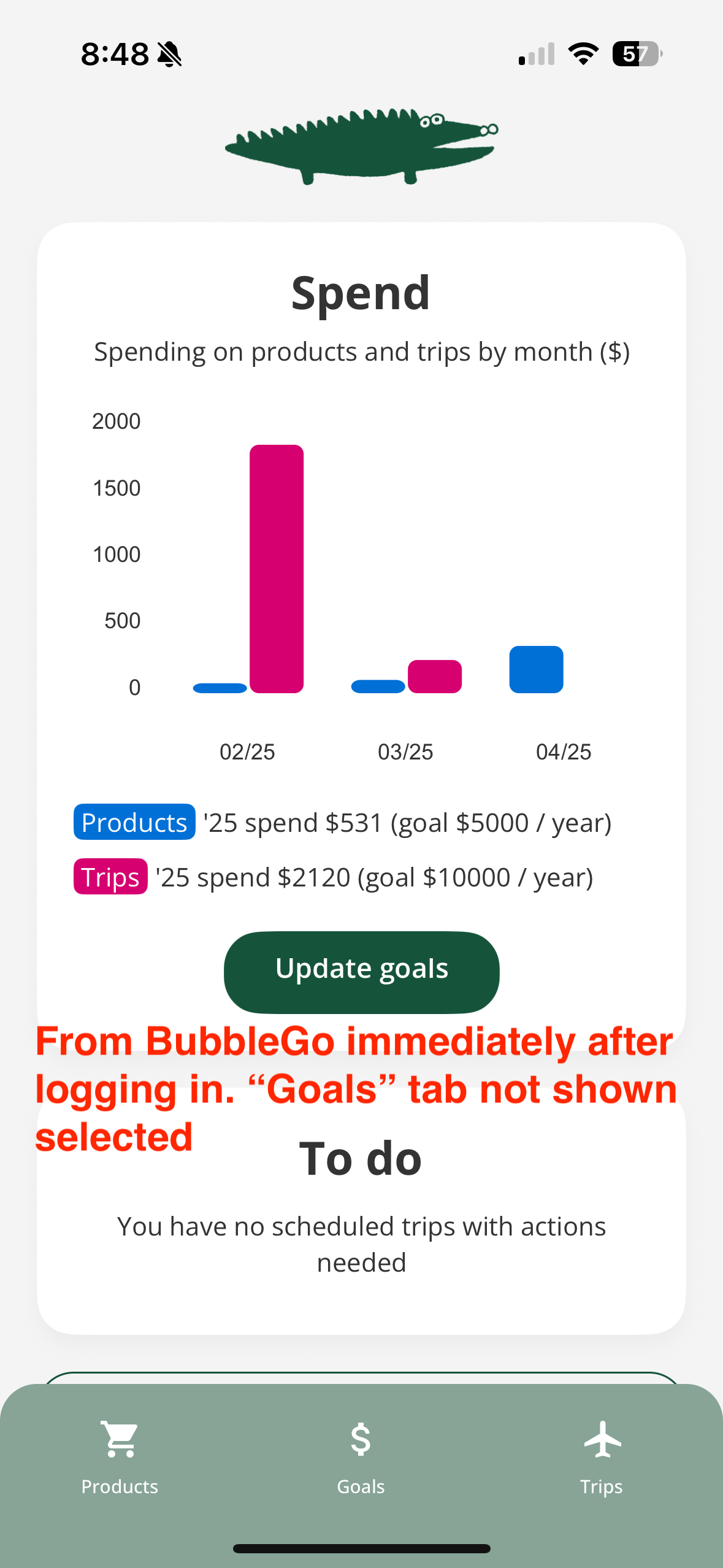

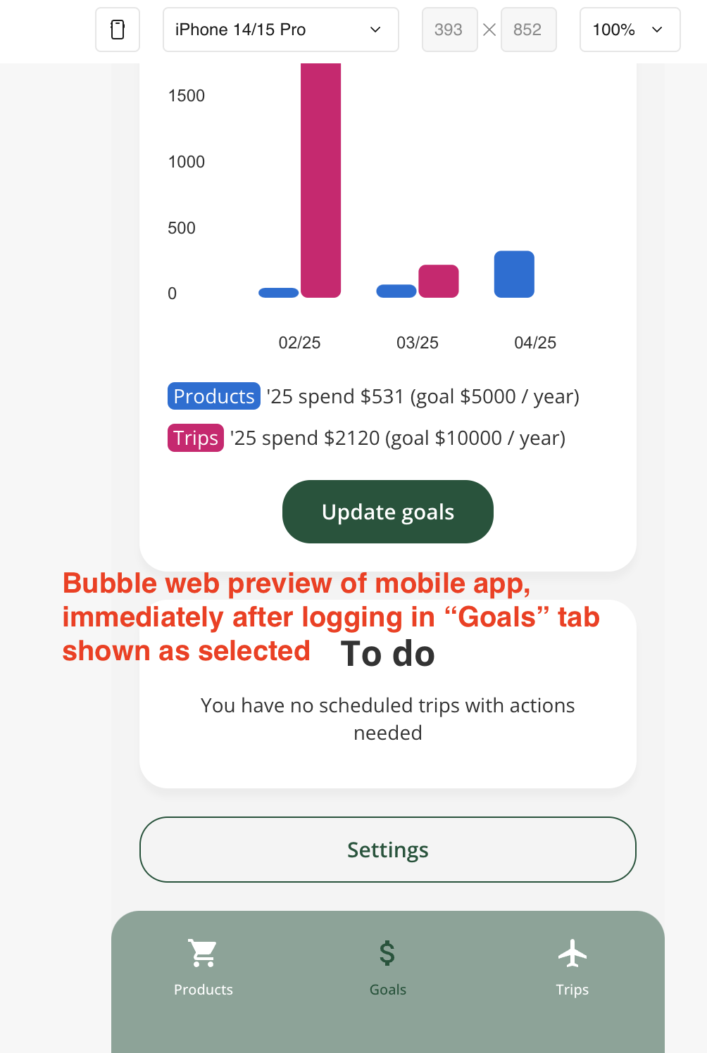

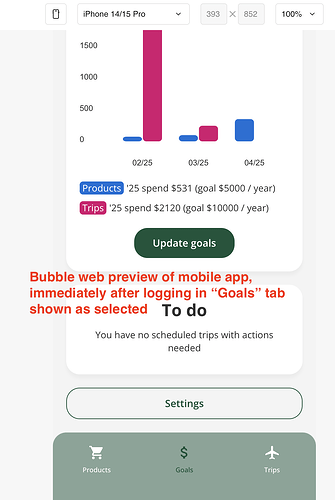

I should note when viewing the preview of my app on web the tab is shown as selected immediately after logging in. But on the BubbleGo and Testflight after logging in the tab is not shown as selected.
This is odd sorry this is happening to ya man. Check your bubblego is on the latest version, and maybe play around with setting the background of the tabitem to a colour to see if thats working. Otherwise lodge a bug report :slight_smile:
