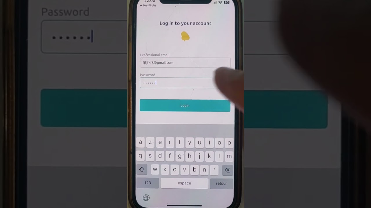

TestFlight - Time to update your app after login
Anyone has got this bug in Apple TestFlight?
It’s not even checking the credentials, I can input anything it would go directly to the “Time to update your app page” after pressing login
So I tried to re-deploy the app, but it hasn’t changed anything.
Maybe I need to use the Signup/login with a web browser action instead ?
