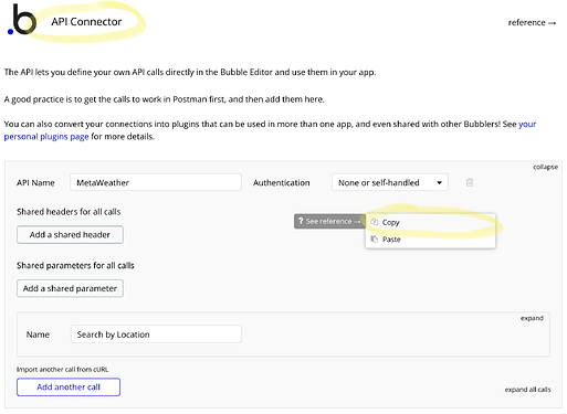

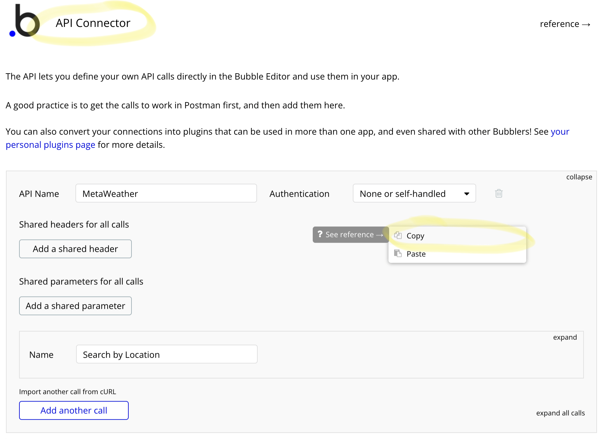

The interfaces are nearly identical. Not only that, but you can copy/paste from the API Connector to the plugin editor’s API tab; so when you’re finished with your calls in the API Connector, you’re nearly done. Just right click on a call to get the copy/paste menu.
Note also that the API connector says you can “convert your connections into plug-ins”. I’m honestly not sure what that means unless it’s referring to the ability to copy/paste calls.
