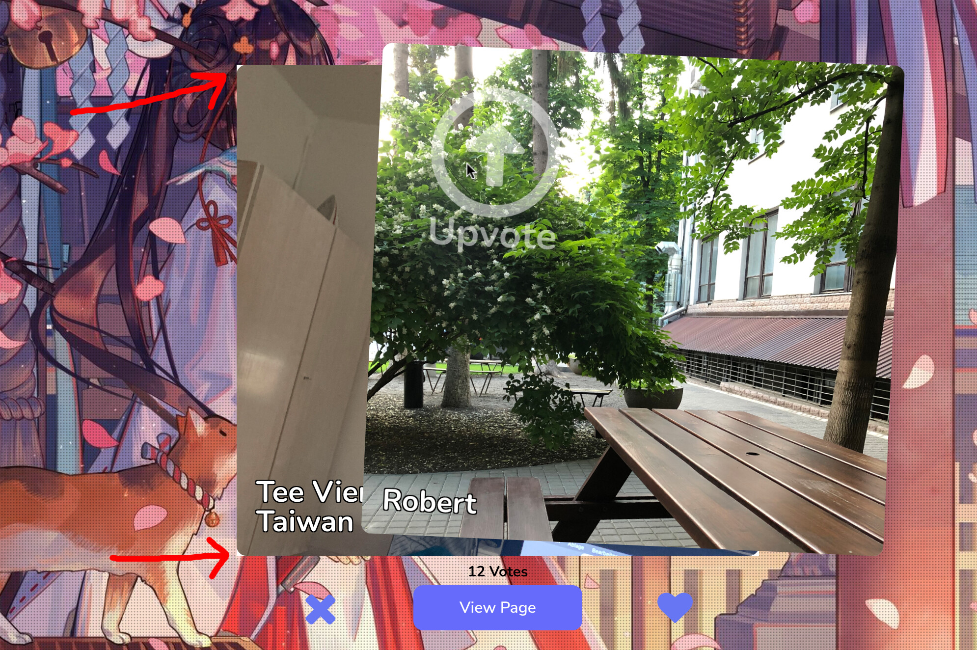

Hi @eren I have a hard time making the edges round of the tinder Tinderswipe element. When I use the bubble round corners option it is rounding the edges of the tinder cards but not the element itself. Therefor I see some white edges against the background that I want to remove. Do you have an idea? (Really love the plugin btw, one of the coolest on Bubble).
