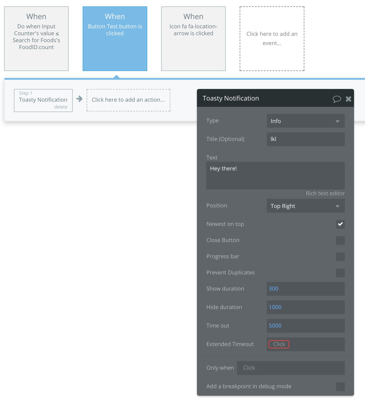

I just set up the action “Toasty notification” in my workflow to be triggered when I hit on a button as you can see on the screenshot.
And when I hit on my button, nothing’s happening, I can just notice the issue in the workflow debugger:

From the screenshot above did you set the extended timeout in the workflow? It looks like it’s empty
Try setting a number there and let me know if your still facing an issue.
Thanks for replying so quickly.
Yes I tried with and without value (as well as dynamic value) in the Extended Timeout field. I got the same result.
I also tried with all kind of combinations (check/uncheck “Newest on top”, “Close Button” etc… with all other fields): unfortunately still the same result.

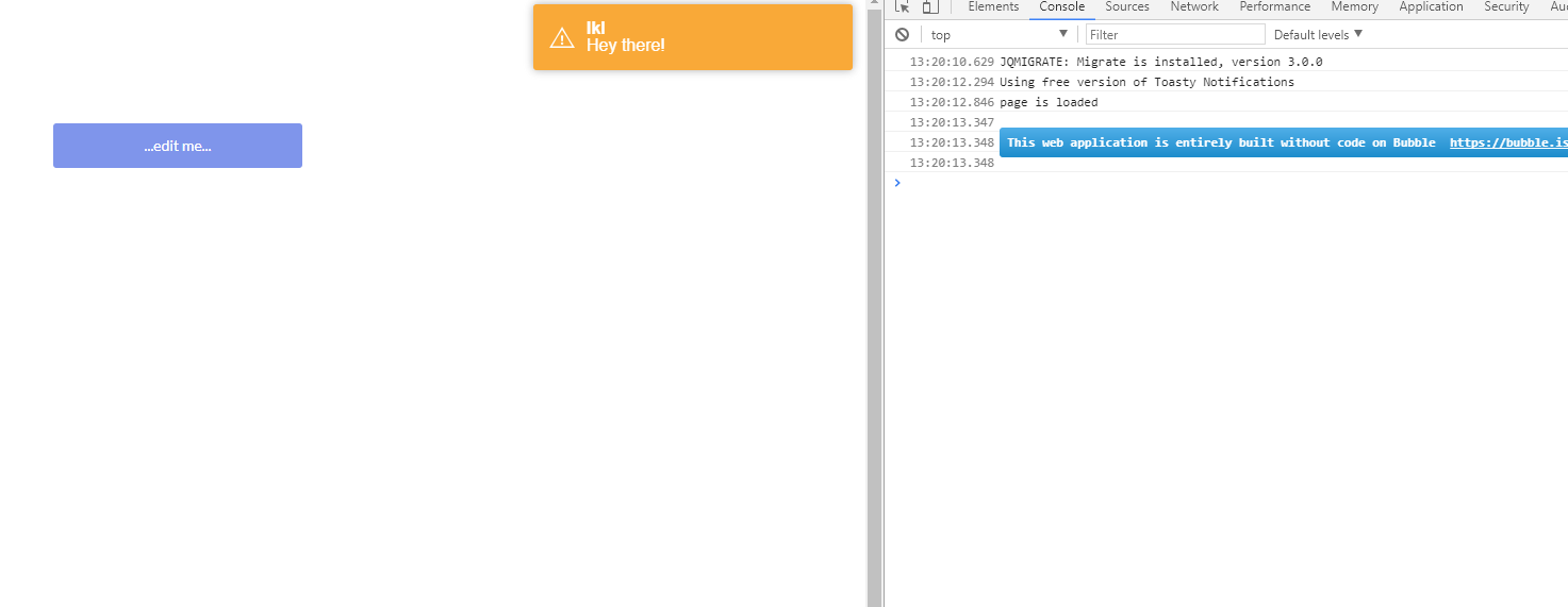

I did some testing, and everything is working fine. Try to upgrade to te latest edition or maybe uninstall and re-install. I will also check if you have any custom JS interfering with it

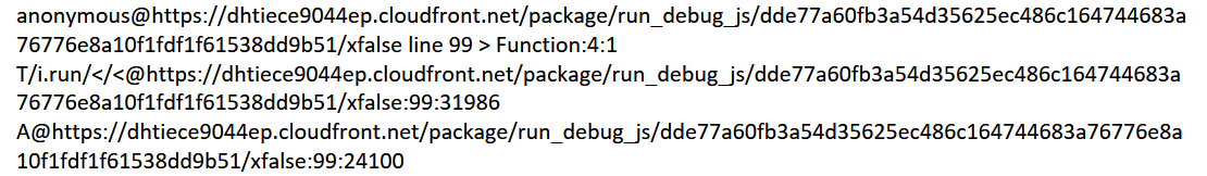

Lot of errors like these:
anonymous@https://dhtiece9044ep.cloudfront.net/package/run_debug_js/dde77a60fb3a54d35625ec486c164744683a76776e8a10f1fdf1f61538dd9b51/xfalse line 99 > Function:4:1 T/i.run/</<@https://dhtiece9044ep.cloudfront.net/package/run_debug_js/dde77a60fb3a54d35625ec486c164744683a76776e8a10f1fdf1f61538dd9b51/xfalse:99:31986 A@https://dhtiece9044ep.cloudfront.net/package/run_debug_js/dde77a60fb3a54d35625ec486c164744683a76776e8a10f1fdf1f61538dd9b51/xfalse:99:24100
I do not have One-Signal installed, but on a fresh app I have no issues. So for sure there is some interference. Will try to check, but most of it I actually need so not much I can weed out. :slight_smile:
What happens is: on trigger, the progress bar starts running but nothing happens and never finishes. It generates the error above.
