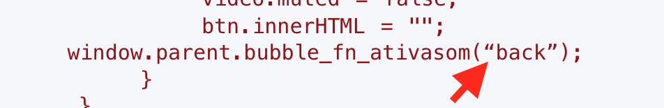

	    window.parent.bubble_fn_ativasom(“back”);
    </script>
It doesn´t work, works only I remove this line:
Can you help me, please?
Have a nice day :slight_smile:
Thanks
It doesn’t look like valid quotes. Please try to use:
Hi @lottemint.md
Thanks for the tip!
Littles details … great results :slight_smile:
Now is runnig, but a I can´t get “back” value on Bubble.
Do you know how if I have to set any expression on JS to Bubble do retrive this value?
