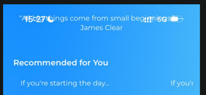

Hey there,
I’m with web app trying to create an app for iOS and android using BDK wrapper. I’m trying to set a top safe area to avoid the problem that you can see below (screenshot from iPhone 16), where the hour and the battery, notch, etc show the page. Instead, I’d like to implement something similar to what Spotify, Youtube, etc have, just a top safe area of a specific color that no matter if you scroll, is always there.

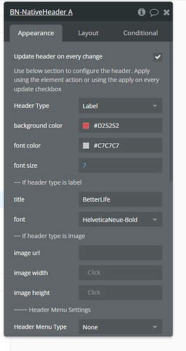

I’m using BDK of @gaurav and I just can’t find the solution for this, below some screenshots where you can see the config.
