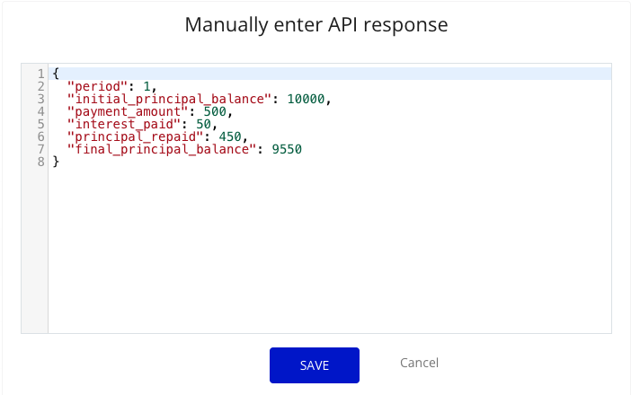

The type of data I’m using is not a Thing in Bubble, but one that I custom defined using the API connector by clicking “Manually enter API response” as shown here:

Here is my Javascript which returns an array of JSON objects formatted just like the image above:
function calculateEMI(principal, annualInterestRate, years) {
// Convert annual interest rate to monthly rate
var monthlyInterestRate = annualInterestRate / 12 / 100;
// Convert years to months
var months = years * 12;
// Calculate EMI (Equated Monthly Installment)
var EMI = principal * monthlyInterestRate * Math.pow(1 + monthlyInterestRate, months) / (Math.pow(1 + monthlyInterestRate, months) - 1);
return EMI;
function generateAmortizationSchedule(principal, annualInterestRate, years) {
var monthlyPayment = calculateEMI(principal, annualInterestRate, years);
var amortizationSchedule = [];
var remainingPrincipal = principal;
for (var i = 1; i <= months; i++) {
var interestPayment = remainingPrincipal * monthlyInterestRate;
var principalPayment = monthlyPayment - interestPayment;
var initialPrincipalBalance = remainingPrincipal;
remainingPrincipal -= principalPayment;
var finalPrincipalBalance = Math.max(remainingPrincipal, 0);
var periodData = {
"period": i,
"initial_principal_balance": parseFloat(initialPrincipalBalance.toFixed(2)),
"payment_amount": parseFloat(monthlyPayment.toFixed(2)),
"interest_paid": parseFloat(interestPayment.toFixed(2)),
"principal_repaid": parseFloat(principalPayment.toFixed(2)),
"final_principal_balance": parseFloat(finalPrincipalBalance.toFixed(2))
amortizationSchedule.push(periodData);
// Break the loop if remainingPrincipal is 0
if (remainingPrincipal <= 0) break;
console.log(amortizationSchedule);
return amortizationSchedule;
// Put in variables
var principal = Input 1's value;
var annualInterestRate = Input 2's value;
var years = Input 3's value;
var schedule = generateAmortizationSchedule(principal, annualInterestRate, years);
bubble_fn_amortization(schedule);
