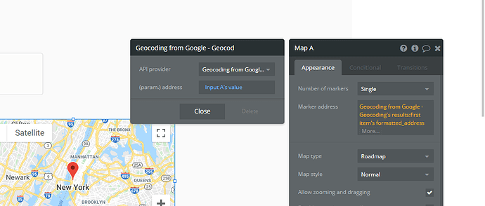

The plugin generates an API call
for example:

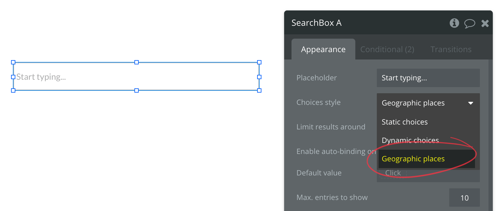

Is there a reason you aren’t using the Search Box element?

I’ve added the element for him earlier @sudsy :slight_smile: I’m sure you will be able to figure it out @david26 ! Key point is not to give up! And I’m far far from being an expert :slight_smile:

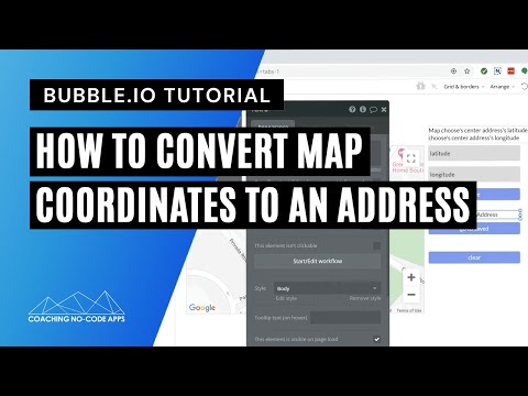

@david26 If you are interested in converting coordinates to address or vice versa here is how to do it. It also explains how to save the values.

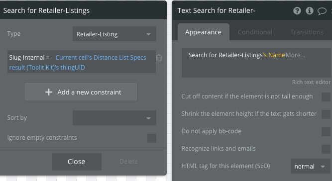

Set up a workflow like so
On page you have a RG with datasource set to
Screen Shot 2020-11-10 at 11.11.17 PM
Then to display the information regarding the thing you are showing use a do search for and constrain using the UID
Screen Shot 2020-11-10 at 11.12.21 PM
