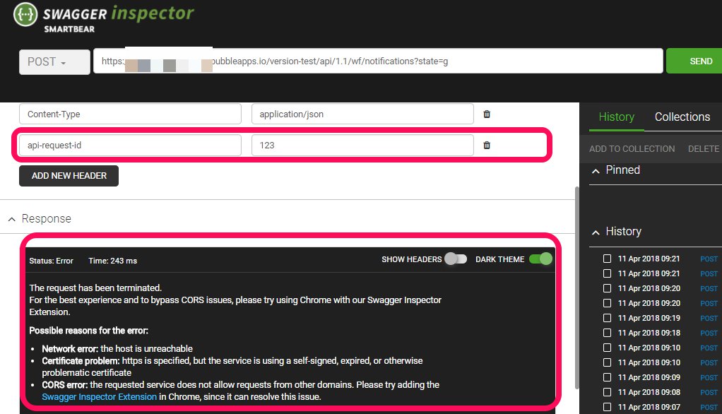

When I try and include Headers in my endpoint call for testing purposes there are errors but it works perfectly fine without them. And the App I want to connect to sends a webhook I need to access, but it has data in the Header

My app has an Endpoint /notifications
When certain events get triggered in another application, they will send a webhook to my app, and they use the callback url of /notifications
But they also include 2 Header strings. I could not verify my endpoint was being hit when the events in that app occurred so I have been testing the endpoint in my app using a few API testing sites

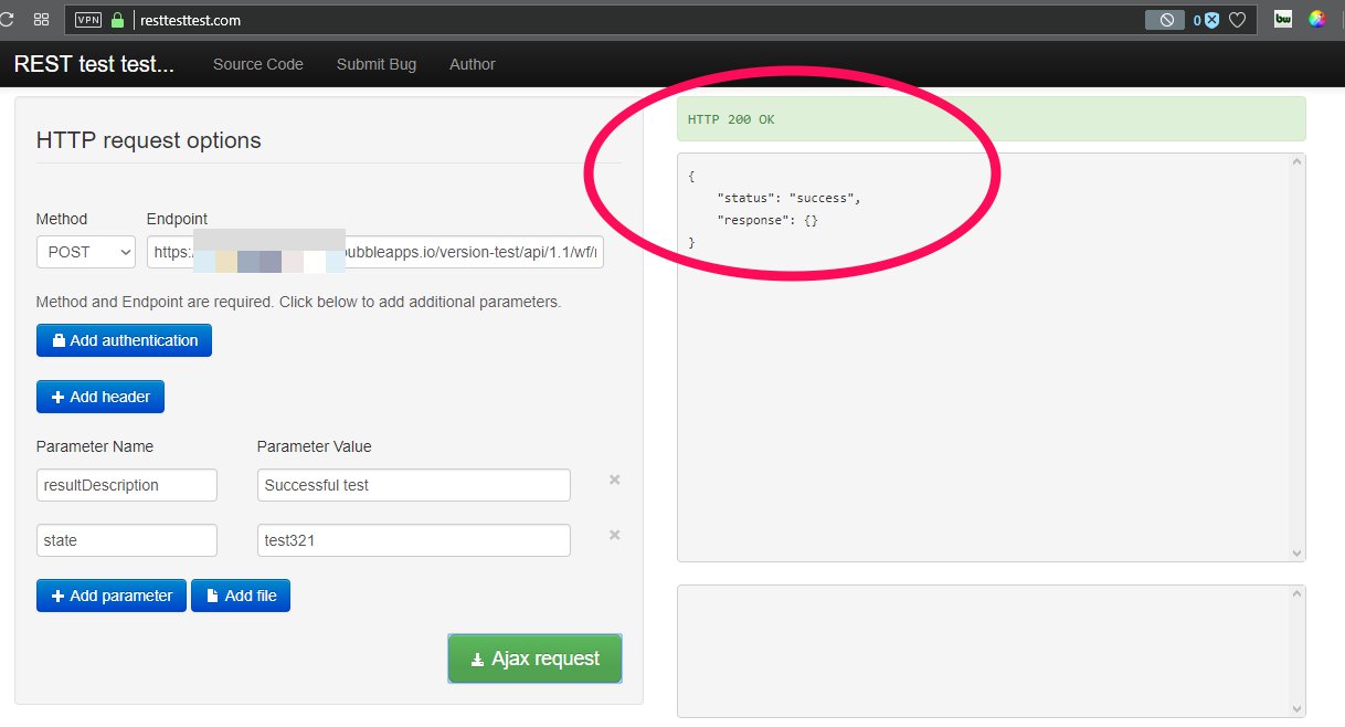

The endpoint works perfectly fine with this setup, with no Headers set:
But it always fails when I include any Header (tested in 2 spots here)
Any idea what is going on here? Do I need to accept or parse the Header strings in the Bubble app somehow for the call to work?

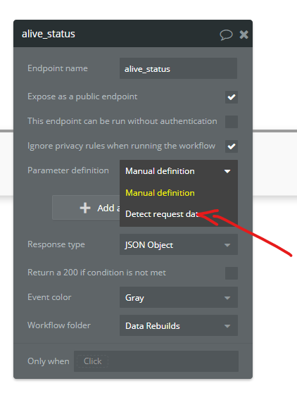

It should work. I know nested arrays are a problem but it should still work. Follow the instructions in the bubble manual
Edit I changed the content-type to application/json used the json data from the 3rd party in the JSON text box, sent it to /initialize, recieved a success and everything looks fine, tricked it perfectly
however when the webhook comes in it executes the apiworkflow but what comes in lookes like this (taken from the logs)

off the bat you would think that doing detect data would work however I cant subscribe the endpoint to the /intitialize address.
I am trying not to send the above json data via a an API connector call however it is not picking anything up, im pretty sure this is to me doing something wrong, I am currently just pasting that data into the json BODY of the apiconnector call.
