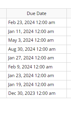

Does your data type of Bills have a data field that is of type date?
yes due date is a date field.
Screenshot 2023-12-28 104134
Thats where the problem is.
‘Due Date’ is a specific date. ‘Current Month’ is (I assume) a date rounded down to the month (eg 1st Oct 2024 12:00 am).
The two can only be equal if the due date is on the first of the month.

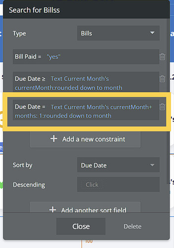

That didn’t work. As you can see in the screenshot, it shows bills from December and January. If I change the date from December to January, it shows bills from February.
Screenshot 2023-12-28 114004
It looks like ‘currentMonth’ is not the first of the month like I had assumed, it looks like it’s anchored to current date/time instead.
You can fix that by adding :rounded down to month at the end of both the constraints.
That worked. Thanks!

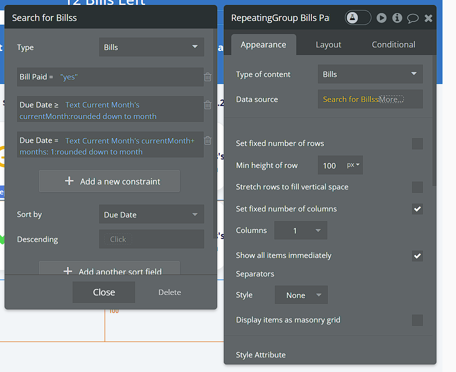

I tried doing the same to the bill-paid repeating group, but that didn’t work. Is there a different approach?
You’re using due date equals:
Yes as Adam said, you accidentally used ‘=’ instead of ‘<’ :slight_smile:
