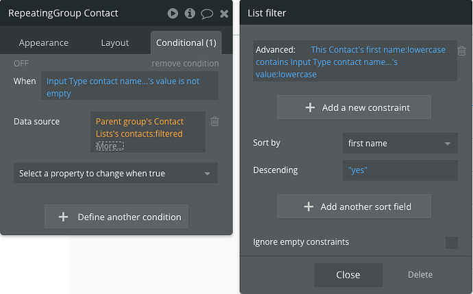

You don’t need to duplicate your database or have a separate field or save a new state. Just use an advanced filter to process the field as lowercase and then process the search input as lowercase as well.
Here is an example of using it to search for contacts within a list who have a first name containing text from an input field:
@deliriousmiles this might have been a viable solution before, but with Bubble’s new WU pricing, using advanced filters will cost you a lot of money and kill your app.

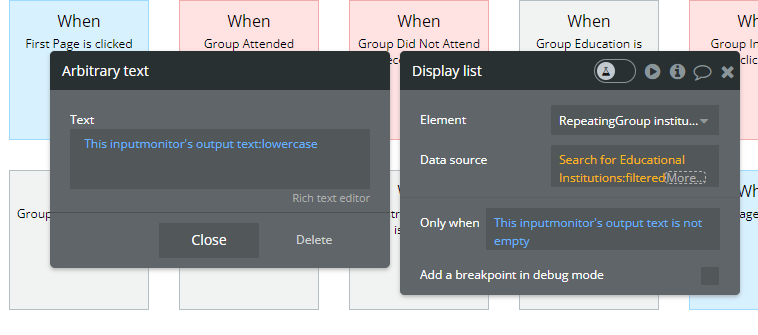

Bubble won’t allow me to add lowercase on the search term:
I am getting around this by comparing it against an arbitrary text and there applying the lowercase.
Still I find it weird that you can do this while I can’t.
