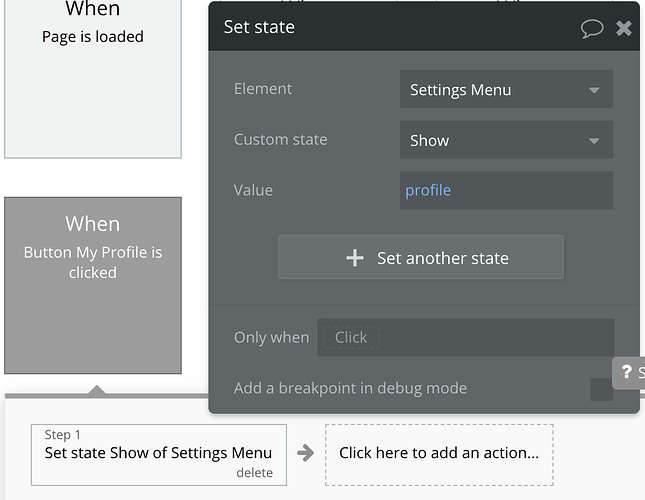

Hey there, the way I set up tabs is by first creating the menu (buttons or text elements) and any time one is clicked I set the state of the menu to show (element actions>set state>create custom state>show -thats what i called mine) and then just the name of that tab.

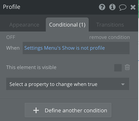

so now each time a button is clicked the show state of the menu changes to that buttons value, profile, settings accounts, etc) and then i add a conditional to each tabs page like so
I use a double negative on the first tab because when the page loads thats the one that is shown and it needs to be changed. The rest of the tabs are when state show is x this is visible instead of when state show is not x this is not visible.
