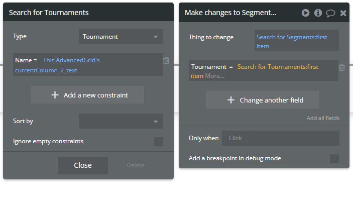

  1. Is there a way to indicate the correct type for reference fields and use a dropdown in the edit form? When using a column that has an Option Set type or a column in another data type the field simply shows text (and accepts any text). For editing, the method below does not work (it looks like it expects a boolean value):
The option set is this:
For pointer (to other data types) fields it doesn’t work either (Tournament is a Data Type and participates as a reference field in Segments):
