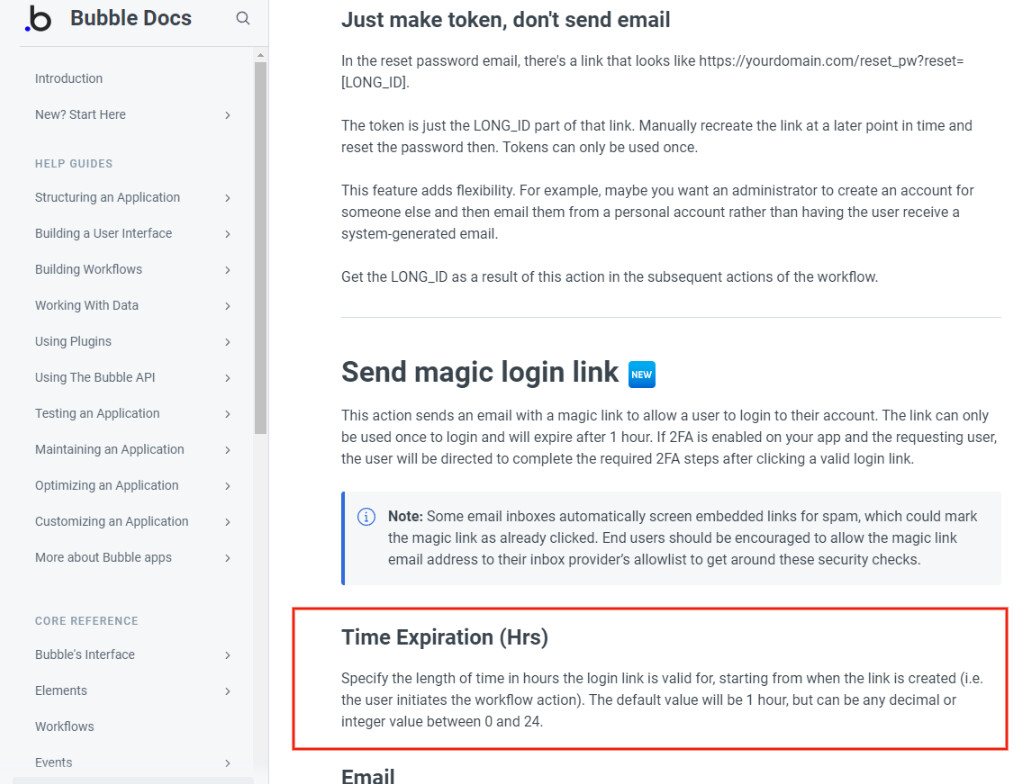

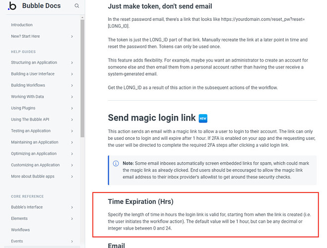

As for setting a time for user being logged-in … the link can be set to be valid from 0 to 24 hours. After that once the user logs in I do not know how to set it other than monitoring for those users who get emailed this link and then build a timer when the app detects an action. Or when the page loads … start a timer?
