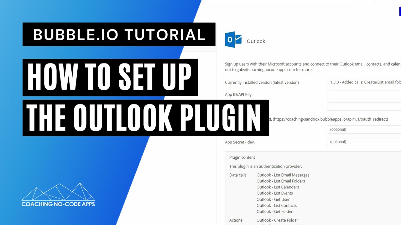

To help you get started, you can use this video as a baseline in creating one to your liking.
Check out the video on choosing the API permissions. For basic functionality, probably their ‘read basic’ options.
That plugin page should be open source. So you can see how the setup behind the scenes.

On that note, I stumbled on this (fairly new) Bubble plugin “Login With Microsoft” which works on the same principles. I created a new Application Registration in Azure Active Directory, copied some IDs and secrets over per instructions in the video, and it worked!
